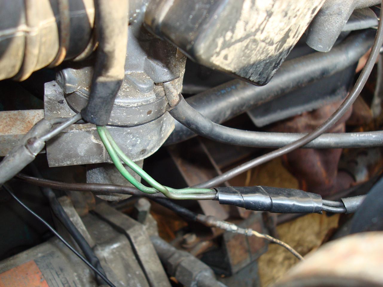

I have been trying to track down the cause of my stalling problem i have been having when i come to a stop. FastWoman has been helping me get this far, tried cleaning the cold start valve and replaced coolant temp sensor, but need to post some pictures to identify where these two attach, to determine if they could be part of the problem. I think the harness attached to the thermotime switch (which has been disconnected). Does anyone know where the vacuum hose could have been connected to ?

I see some discoloration on the green wire as if it gets hot or got too hot at some point or another. Is the vacuum line plugged into the bottom of the AFM? If the car had a previous owner no doubt they had an issue and that was the solution they came up with.
Having the thermotime switch disconnected can cause idling issues as well. It tells the ECU that the car is warm enough and allows the cold start valve to close. My suggestion is find a good Z mechanic and let it get sorted out properly. No point in throwing unecessary parts at it. Good Luck.
Can't really see a disconnected vacuum hose in your picture.

Your picture shows the side of your throttle body. If you mean the small hose connected to the port in the center of the picture, that would be a ported vacuum source, maybe to your charcoal canister, or the distributor vacuum advance. What is the open end sitting close to? There is another bigger hose that goes to the charcoal canister. If that is open, you might have a vacuum leak.

You are correct the hose comes out of the throttle body, the vac hose to the canister that t's to the vac advance on distributer is connected. The other canister vac hose is connected to the intake manifold. This hose was disconnected some time ago by PO and is not located neer anything just curled up on the wheel well.

The part in your picture is the BCDD ("boost controlled deceleration device??"). It's a doodad that drops your engine RPM gradually when you come off the pedal, by introducing additional air. If it's like most BCDDs, it's defunct now and has no available replacement. The good news is that it's not really that necessary.

Well i got everything sorted out, my first thought was that the hose attached on top of the dash pot, FastWoman set me straight letting me know that no vacuum hose attached to the dashpot. I then got to thinking, the car started stalling or almost stalling after i removed the dash pot thinking it was just taking up space and looked like crap on the front of the engine. I cleaned it up and reinstalled it, no more stalling. As for the mystery hose, i looked at the shop manual and found where it was supposed to attach, the first nipple on the thermal vacuum valve. The second nipple is broken off so the hose that goes to the bpt valve is attached to the first nipple. All three components in this series are non functional, the fitting on the btm of the bpt valve is broken off and the steel line to the egr housing is plugged off. what a mess, i am glad i live in Alabama where there are no emission checks, this car would never pass.
