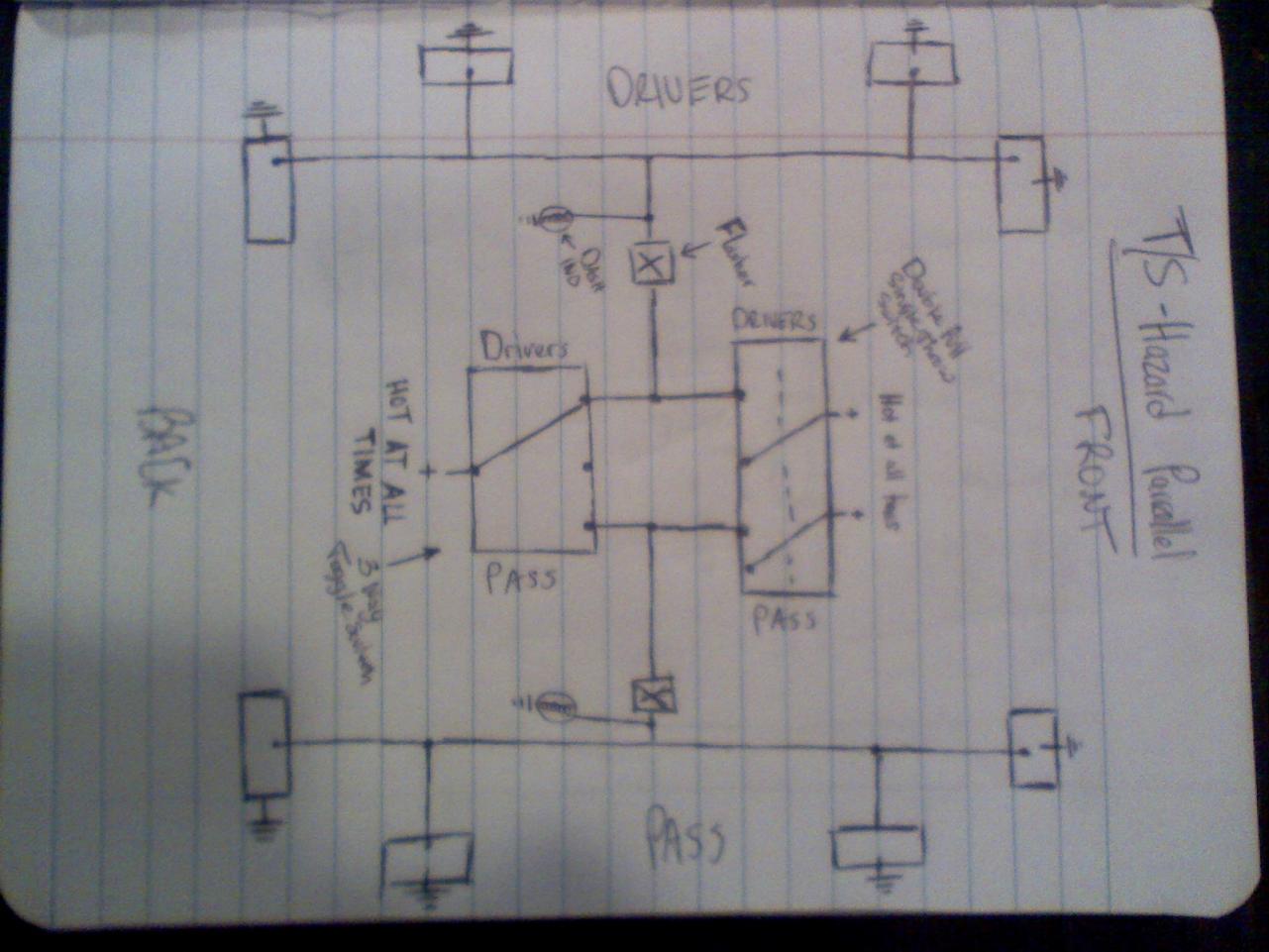

i have been working on some super simplified wiring diagrams as i want to seperate each individual circuit by itself to its own toggle switch. im sure i may be missing something here or there so feel free to critique the diagrams to make sure im not missing things XD

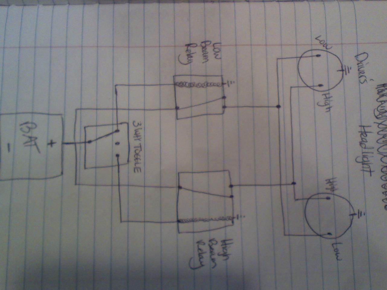

and i went the relay route on the headlights so i could use smaller wire through the car and have a fatter wire straight from the battery to the lights... i cant think of any problems with this set up.. can anyone else see any?? haha want to make sure this is actually gonna work in real life LOL
