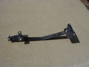

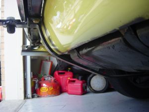

If it's the one I have seen, it bolts to the bumper and the rear valance. As you know the metal on the rear valance isn't much.
I have seen one. The guy has a piece of angle iron going from bumper bracket to bracket bolted to the body, then the bumper. Then he has a piece that is bolted to the angle iron and that attaches to the rear crossmember for the diffy.

The 280z had one that bolted to the bumper brackets and had another bracket going over the top of the gas tank bolting the body.

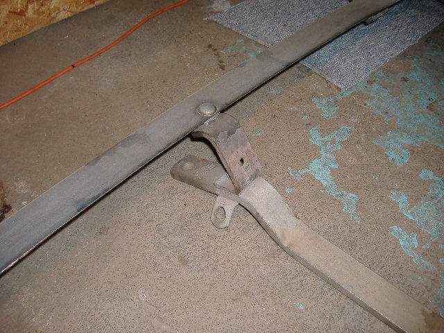

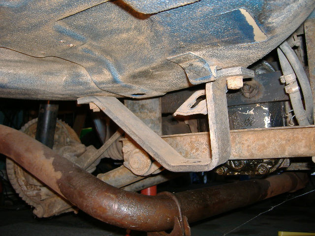

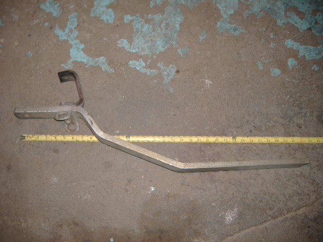

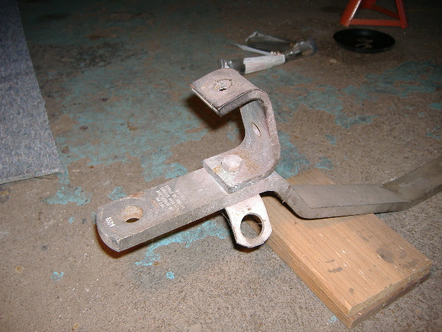

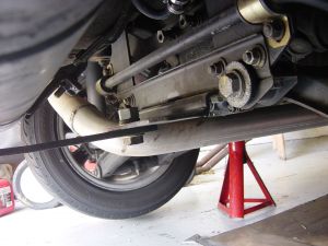

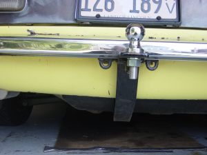

This is what it looks like and mounting points, not the best, but it worked. Photos won't load, will post later.
Bonzi Lon

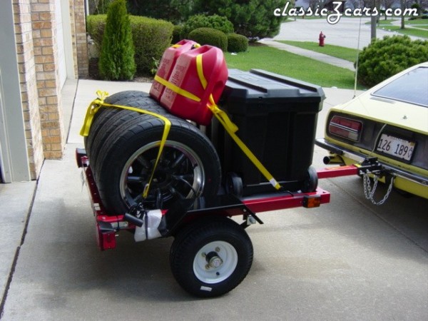

I used to pull my tire trailer behind my Z with no problems at all. I hardly knew the trailer was back there when towing. Of course I didn't have a lot of weight on it either, probably around 350 lbs.
My Hitch was mounted behind the bumper to the bumper mounting holes in the rear of the car. A strap then wrapped around the gas tank and was bolted onto the rear cross member. It was made of very heavy gauge steal. This provided for a very solid mount to the car.
