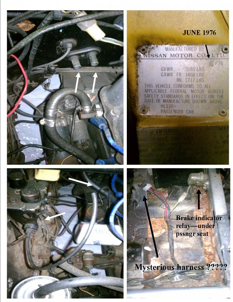

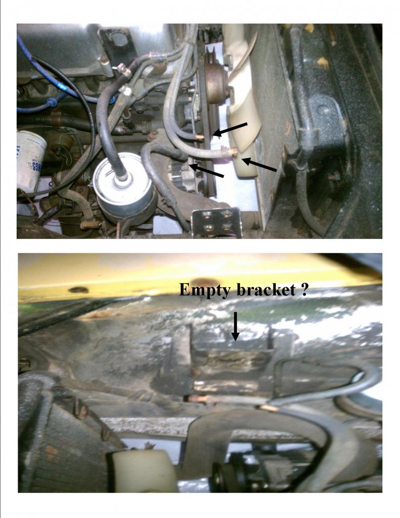

1. Heater hose flange on firewall - intake/return - disconnected - only reason i would think this was done is that there is a problem underneath dash - they looped the intake hose from the pump back to the block - any other reason why this benefits or hurts performance ?

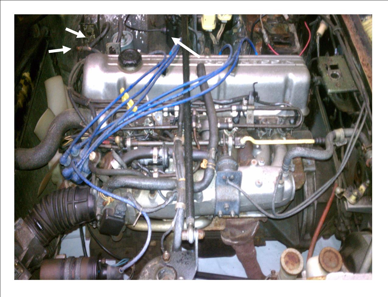

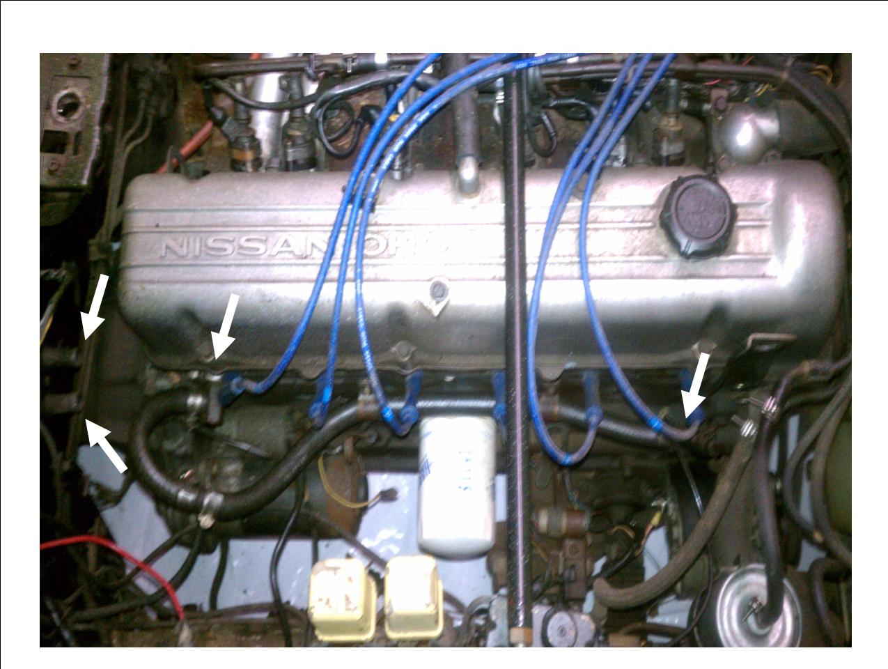

2. Many breather/coolant hoses are disconnected plugged - im hoping most are elimination of emissions
3. I was told that this engine is from a later year other than the original 76 (?) where do i find engine tag (?) any indication from photos?

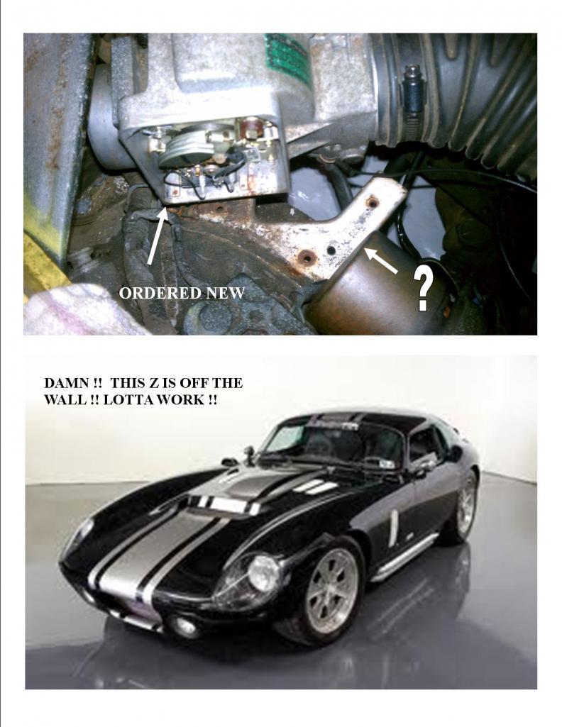

4. Empty brackets - Engine compartment - front right passenger side (photo below) & blank bracket near air intake - front left (below AFM)

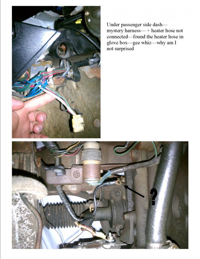

5. Under passenger seat near brake relay - mysterious harness?? (photo below) / Passenger side - under dash - another mysterious empty harness?

As far as the original engine, there should be an ID plate on the right front strut housing with the engine # on it. There is a stamped # on the block at the right rear area, betw. the 5 + 6 sparkplug area. Compare the two to see if they match. also agree that there is a heater core leak; that is why the coolant lines are disconnected as they are.
