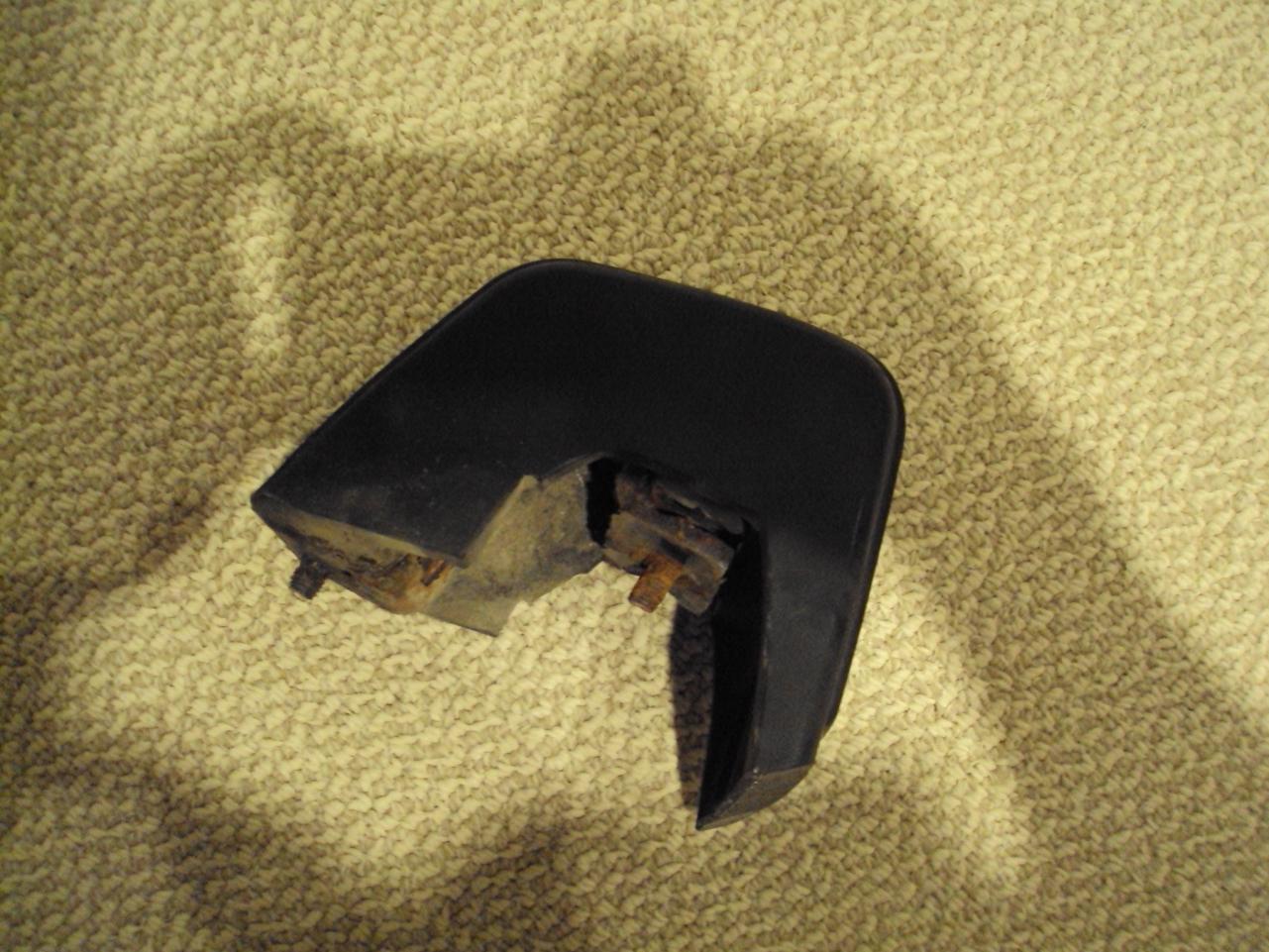

While removing my rear bumper this past weekend I managed to break the bolts that hold the overriders (bumper guards) to the shock absorbers. This pretty much destroys the overrider as the bolt is part of a metal insert that forms part of the overrider (see picture below). I have a couple of questions:
1) Does anyone have a set of rear bumper overriders (bumper guards) for a 03/74 260z.
2) Has anyone had the same problem and managed to fix the old overrider. I was wondering if the stub could be cut off and a new bolt welded on.

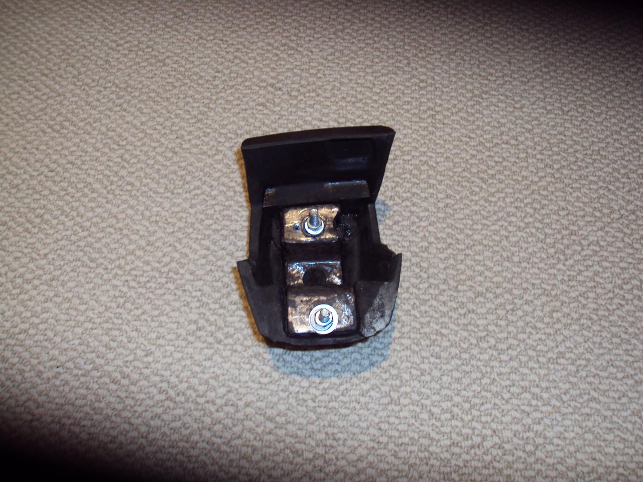

Thanks, but I have decided to try and repair mine. I removed the metal bracket, drilled out the bolts and replaced with stainless steel. I have cleaned up the rubber and I'm nearly ready to try and put them back together, I just have to get someone to weld the bolts into place. I'm hoping that a strong adhesive and a couple of screws should hold it. I will give you a shout if it doesn't work.
