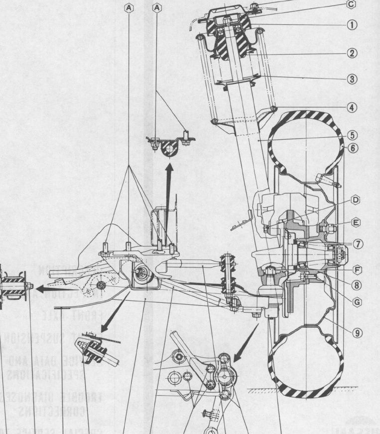

Are you sure, my 240K shocks don't bolt to the axle like that,
Nigel
edit: just noticed you are talking about S13s and s130's my bad..
Edited by Noddle
foot in mouth........
by axle do you mean the knuckle spindle assembly ?
remember this is the fronts,
and as far as i have seen 240k's and 280zx's and S12's all run a variation of the same front strut so this mod should be applicable
My 4 x 240Ks run this
also the disc rotor attaches differently, looks like the S130 slip over the hub, whereas the C110 bolts to the back of the hub
Nigel
Edited by Noddle
none of those parts are used for the conversion so im not sure what difference it makes
Maybe I'm missing something,
I'm showing that the shock / coil-over would not fit on the 240K stub / axle, or do you change the whole thing from a S130 ?
Nigel
everything from a the ball joint to the top of the strut is S13 and all the rest is standard :> the LCA and all the rest is almost exactly the same so it should work the same
I think you would need to change the LCA to get a S13 strut into a C110, maybe a S130 LCA would fit into a C110 and have the different end to connect up to the S13 strut. Not sure to be honest but if it was really that easy I think the rally boys would have done it before and since they haven't. . . . . . . .

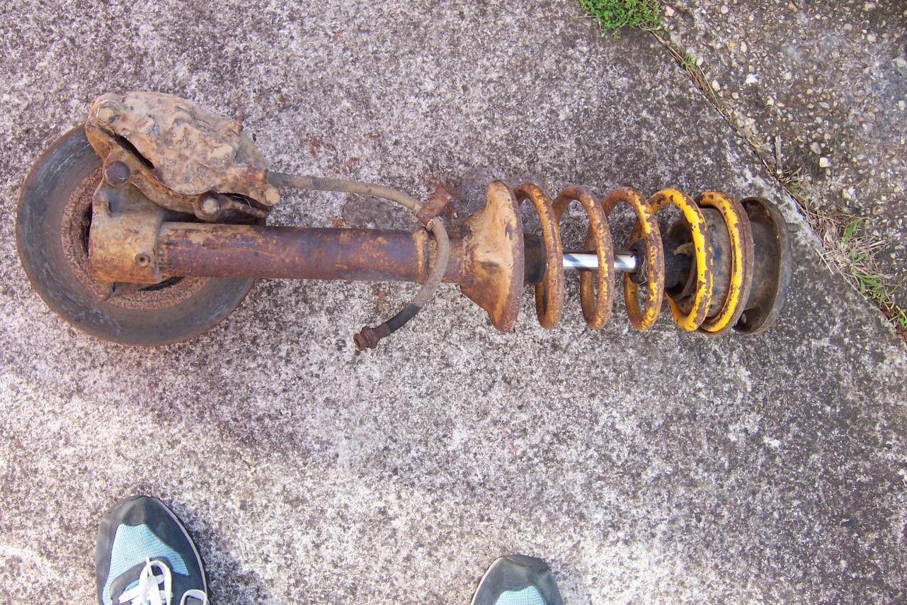

ok so i went out and took pictures of some datsuns in my yard as i didnt have time to find any more or go to where i keep my hard top, i know they are poor pictures and its dark and the C110 is missing its caster/tension rod but here they are.
1974 C110 4door
1983 S130 2+2
1978 200B GL
so not the best way of showing it but from the datsun nuts i talk to and my own experience this mod should work the same way for all of these :>
and i believe that the best way to do it would be with s13 LCA's but this way is less modification for now

The guy I brought my coupe off, said he put 200B struts from his rally car on it (which I removed), I wonder if they are the same part between the 3 cars.
also, the S130 2+2 looks like it's got a thicker sway bar, I assume they are not the same shape ?, or are they very similar ?
