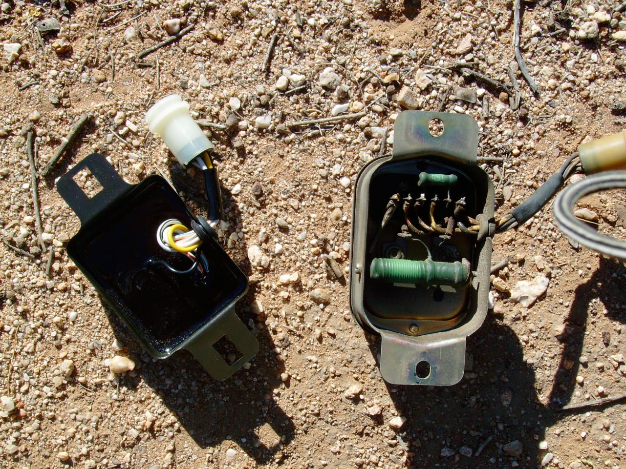

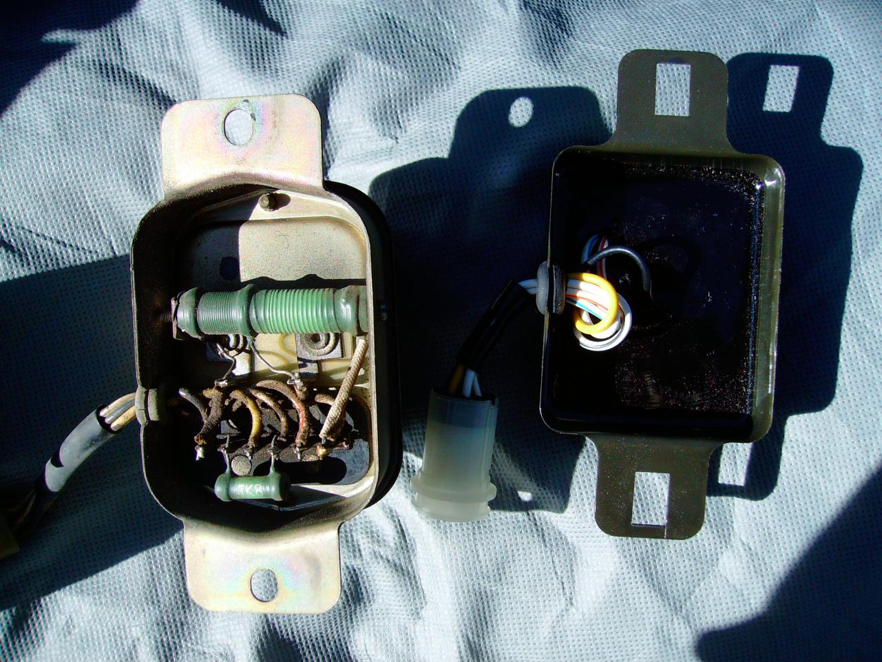

Changed the voltage regulator today. Noticed two things. One the new regulator is roughly half the size of the old one. Secondly, upon opening the old regulator I noticed that one of the coils was burnt out. The little orange paper that surrounded it was all black and brown. So I'm guessing that was the problem.
When I restarted the car (after stripping two of the mounting bolts) the voltage gauge sits right under 16 volts. When I turn on the lights it goes down for maybe a second and then returns to where it was.

Pictures below of the old/new regulator for reference.
