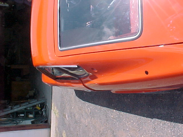

Posted November 18, 200222 yr comment_19288 I have a dilemma. Nice fresh 110 red paint, car reassembly underway, pioneer cd player(model DEH1350) ready to instal but no suitable power antenna for a hole in the rear quarter panel. I request your advise as to a suitable model and brand of power antenna that is both functional and suitable for a 6/73 HS30 . Steve:classic: Link to comment https://www.classiczcars.com/forums/topic/3663-electric-power-antenna/ Share on other sites More sharing options...
