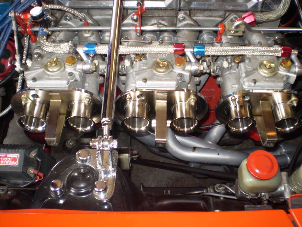

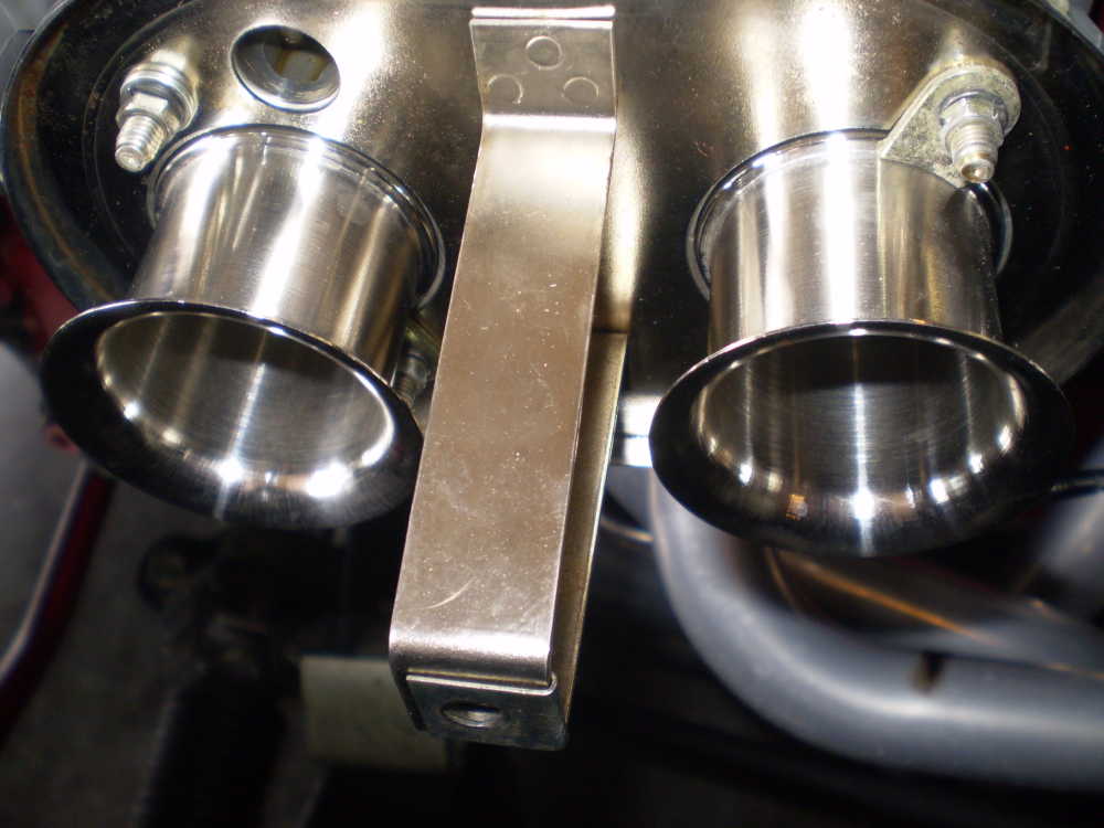

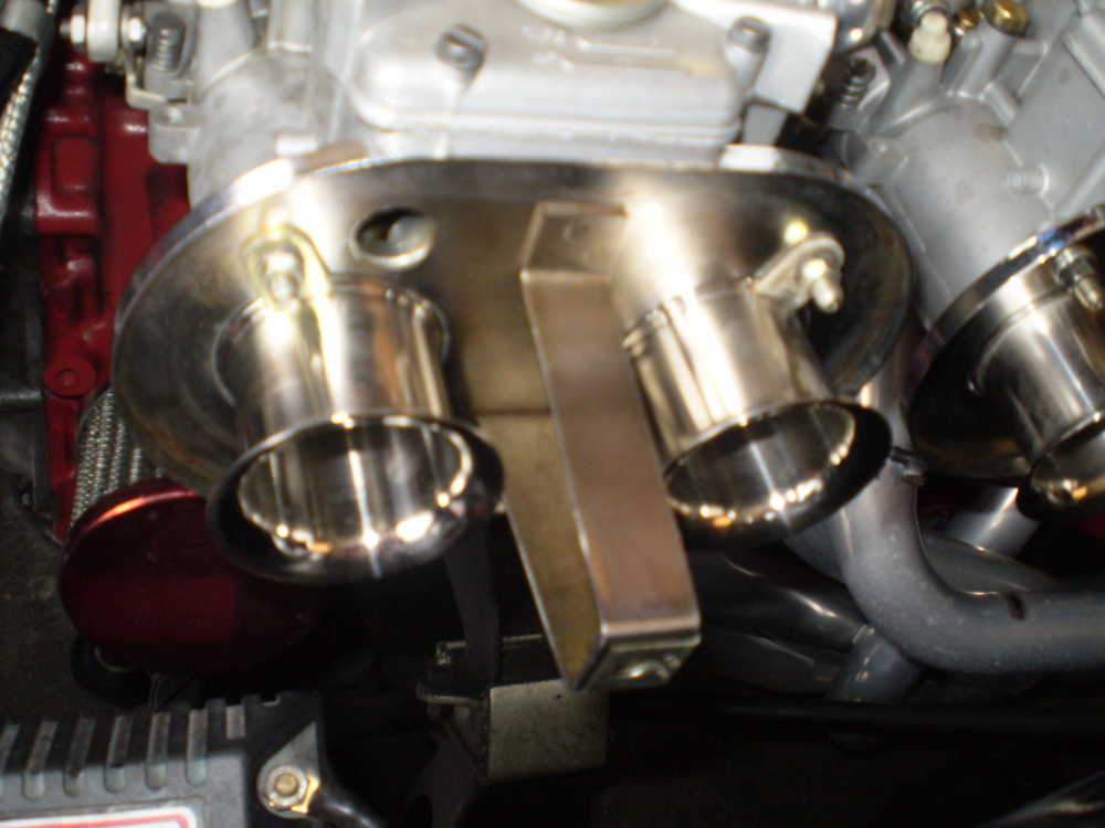

They were designed to run with the Insert style stacks. The insert secures the Aux Chokes and centers them. this hold the aux. in place and in return hold the stacks in place, then use the small tabs to hold them in the carb body.
Although both designs work okay a fully rolled lip on the outside of the air horn will make a significant difference as well. This is race car stuff and not really something you would notice as much on the street.
We have seen crappy air horns create strange problems in the past that were simply solved by installing better air horns.
We have seen a difference of as much as 5 HP and the loss of dead spots in the power curve on the dyno with the TWM style (fully rolled) air horn.
