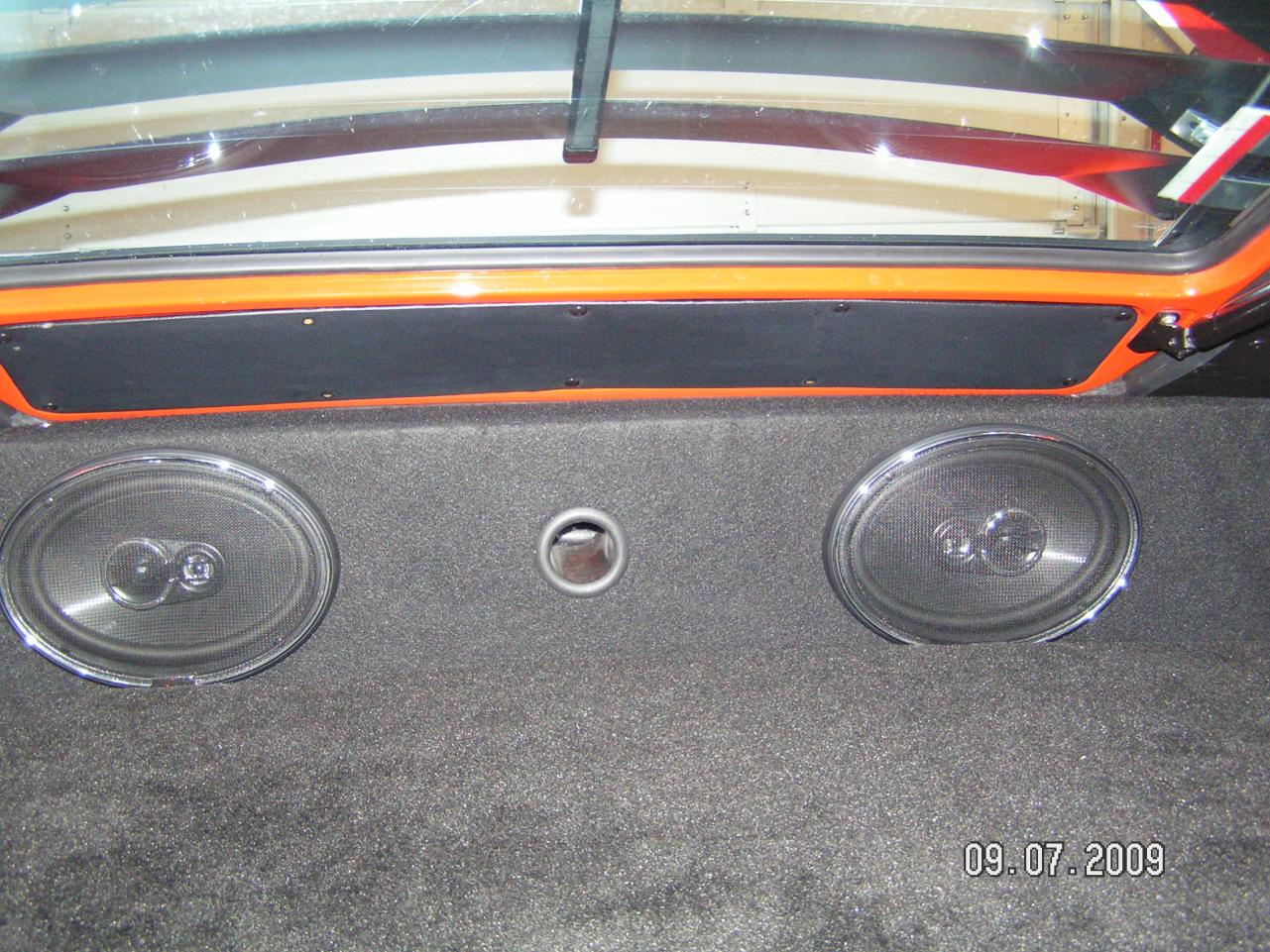

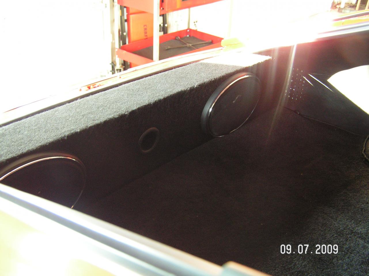

This is my 240Z with the MSA speaker panel installed. I would not hesitate to do it again. There is more detailed info with my sound system in my garage.

How do you get to the bulbs in the tail lights with that speaker panel in?
I have one of those speaker panels on my '73. Two screws on top and it's out. Actually easier than the old finisher panel with all it's rivets. 2 thunbs up for the panel and the sound from the 6x9s.

Pops, do you have just rear speakers, and nothing in the front? I am debating between having just 6x9 in the rear, or fabbing 5 1/4" speaker enclosures and installing them in the kick panels (little room there unfortunately). Thanks.
At this time I have no speakers in front. I am considering adding a pair of tweeters mounted somewhere in the front to add some fullness to the sound experience. FWIW the sound from the rear 6x9s is very good. I didn't want to cut holes in the door panels, and the kick panels seem pretty far away from my ears, plus I didn't want my size 12 clodhoppers to kick any speakers down there. I have seen others mount their tweeters in the "eyeball" vents in the dash.
