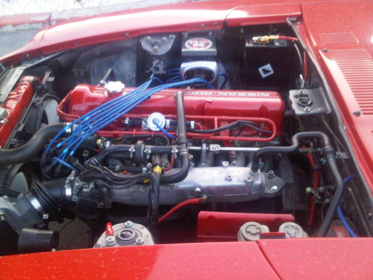

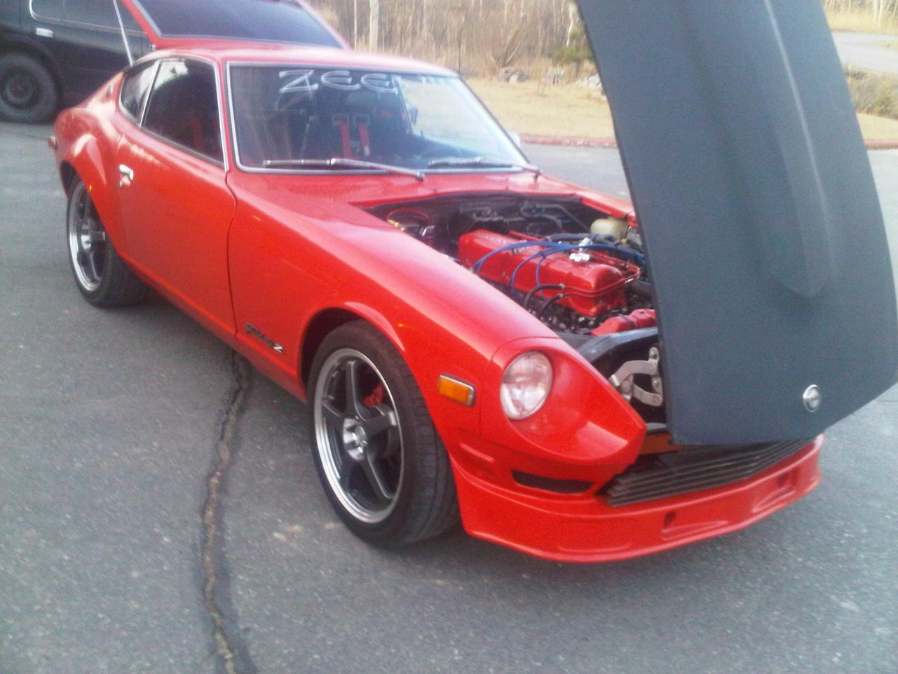

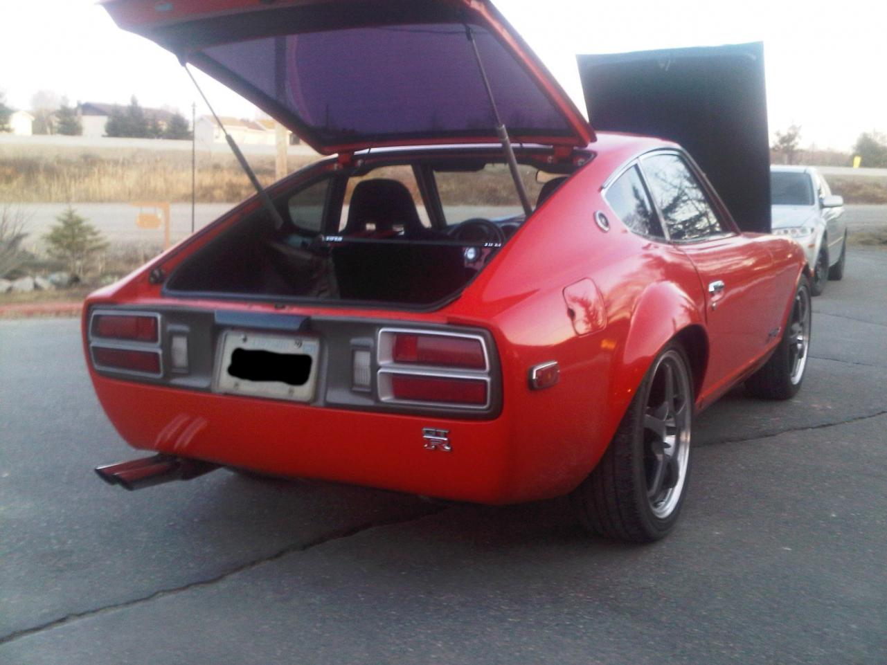

ok got some pics.
sure enough its a 1975 280z with farilady badges, as well as a gtr badge. Owner still seems to think their original but i have doubts (from your info)
converted rear drums to maxima disc brakes, original mechanical fuel injection, factory headers, aftermarket wheels and racing seats.
probably not the ideal car for a collector looking for an 'original'.
biggest thing it needs is paint.
not a big fan of the whale tale... :(
comments?
