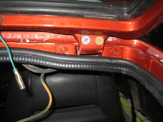

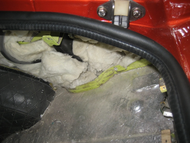

Now the real payoff. I'm also doing the hatch weatherstrip too so I couldn't resist trying the Kia strip on it. Not gonna fit, right? Read on.

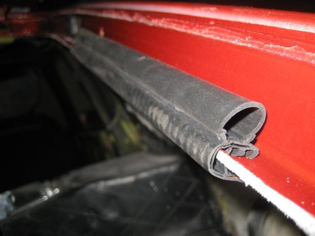

First I took a 6 inch section that I had cut out of the door and pressed it on the hatch lip. Even though that lip has that 1/8" or so turned up lip, it fit right over! The slot is plenty wide. I closed the hatch and looked from the inside to check the fit. The bulb compresses perfectly about 3/4 of its thickness. (pic below).
Now you know I had to try the whole hatch lip. With the hatch on the car! Try this with the "real" weather strip that has to be glued! Only crazy people try that!

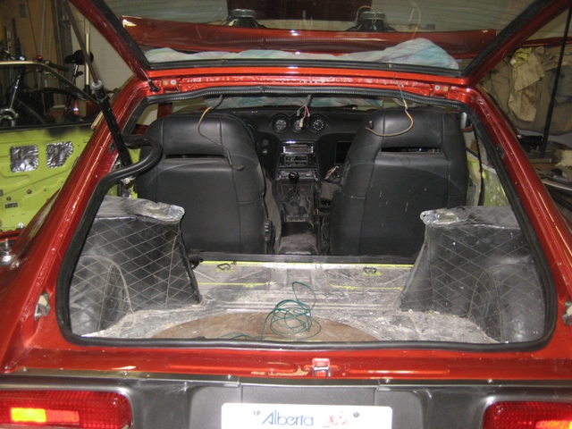

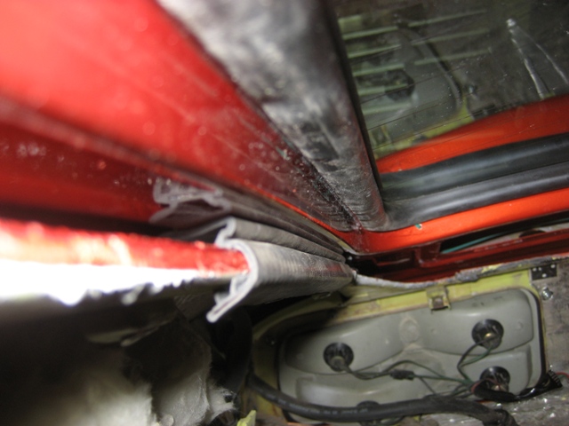

I had only done the passenger side at this point, so I had the un-cut driver side (not that they're any different) to try out. No way its large enough for the whole hatch but I started anyway, had to see how it fit around the top part by the hinge!
Well, after getting it almost all the way around, I realized it IS long enough for the entire hatch PLUS about a foot!
I left it long around the strut, and closed the hatch. Perfect! Closes just about as easy with the weatherstrip as without! And no nasty hatch sticky-uppy! Picks of the fit below.
Now the only remaining issue I can think of is water sealing. Wouldn't surprise me if it sealed just fine without glue, but we'll see. Make sure you have the outer weatherstrip in place properly glued on to deflect all the water down the drip channel to the back.
