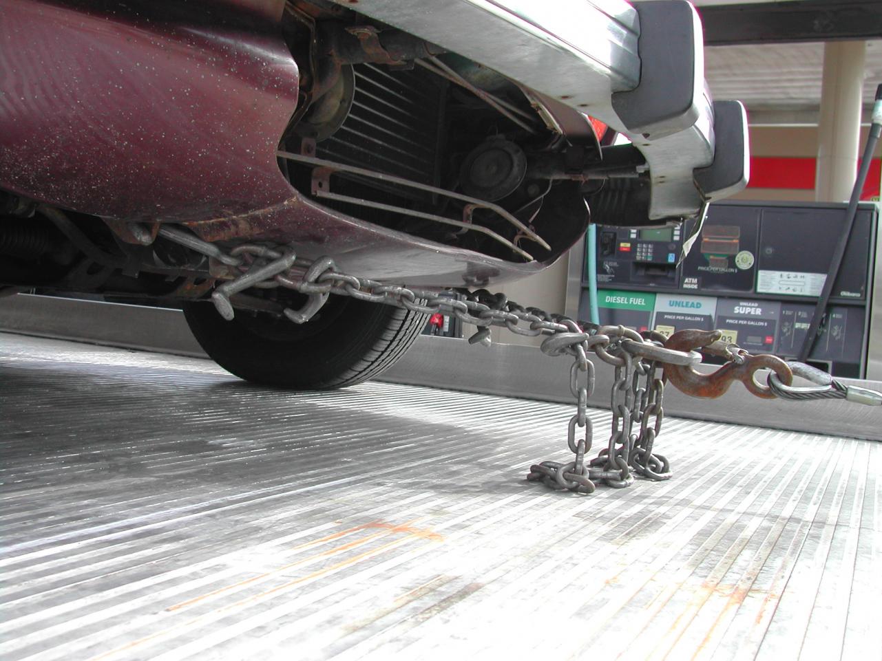

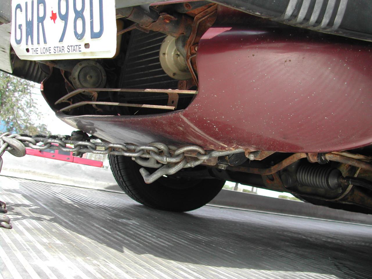

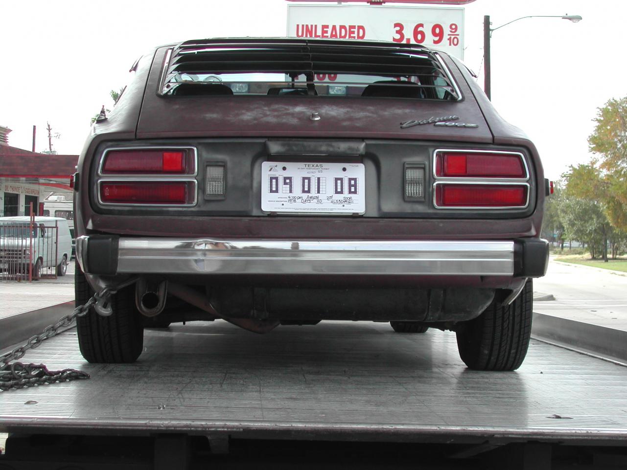

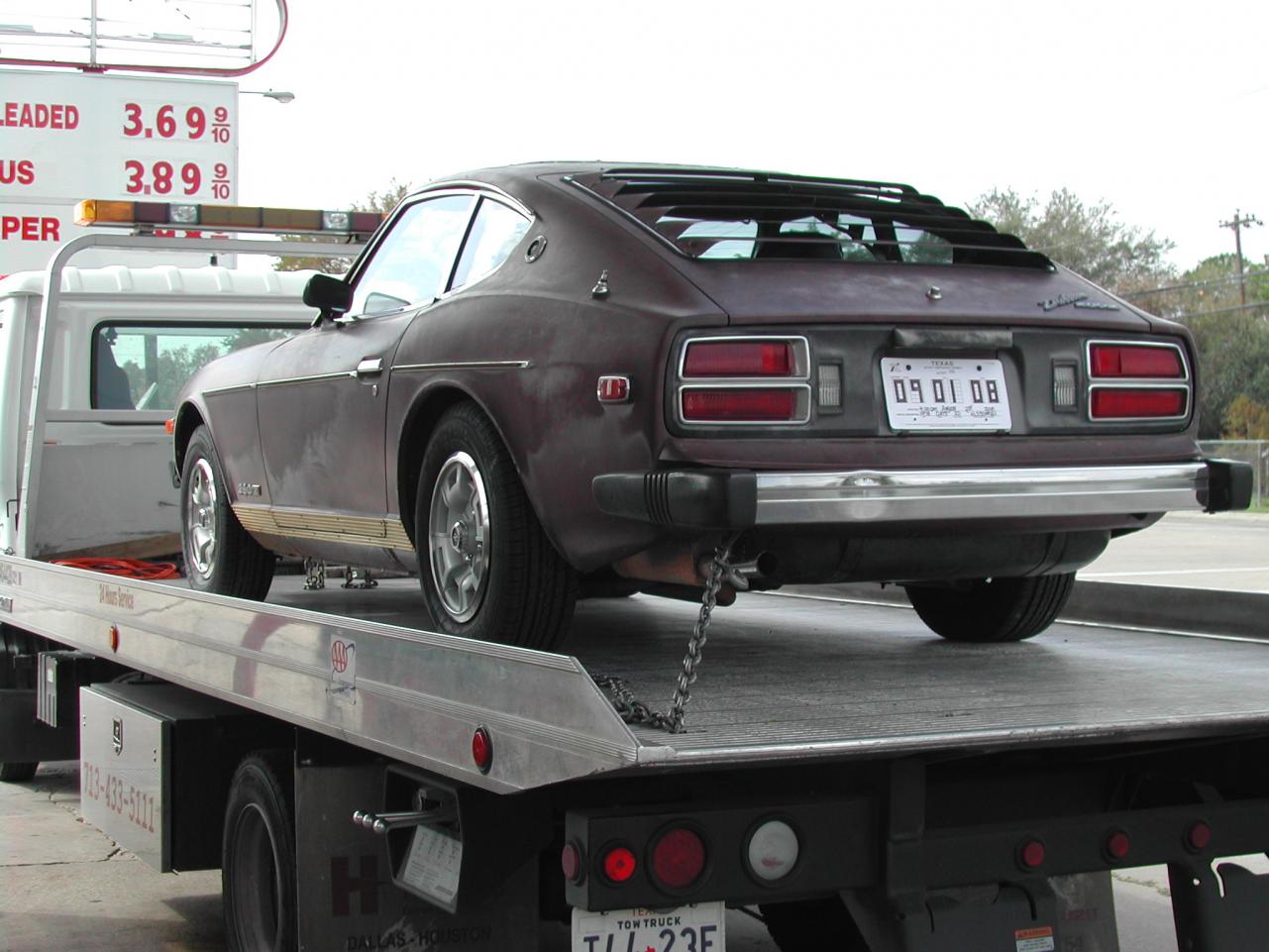

mlaw7 Posted December 26, 2009 Share #17 Posted December 26, 2009 If you're going to have her towed, here are a few thoughts. Definitely use a flat bed. Bring a few towels or other soft materials to use as a cushion between the chain and your car. Especially if the chain will be attached to one of the tow hooks in the front. The positioning of the tow hook can also make a big difference as to any contact it may have with the valence or bumper. The front valence panel (underneath the lower grill) is directly in the path of the chain and/or hook when it tightens. It is thin sheet metal and it doesn't take much pressure from a towing chain to mess it up. If it's being pulled from the rear, put some cushioning between the chain and your rear bumper. And make sure the driver goes real slowly as the chain gets taut. It may have to be repositioned one or more times until there's no contact with your car. Or at least minimized and cushioned. I've been through this numerous times with wrecker drivers. It's not their car and for the most part, they just want to get it on the truck and wherever it's going so they can do another run. He or she isn't going to pay much attention to what that chain will do to your car, and chances are probably couldn't care less. I've had to stand my ground very firmly a number of times on this. Once I had to tell the AAA driver to either do it right or take his chain off my car. He didn't want to be bothered with taking that extra bit of care but eventually did when I threatened to report it to AAA. On the positive side, I have had a couple of drivers who at least appreciated what it was they were transporting and were willing to work with me on this. I've attached a couple of photos to show you what I'm referring to. This particular time I did not have any cushioning material but made sure the driver positioned the chain and went slowly so as not to damage the valence. Either way, if you take these precautions I can assure you that you'll be glad you did! Link to comment Share on other sites More sharing options...
Inf Posted December 26, 2009 Share #18 Posted December 26, 2009 It seems the OP is trying to get this done without spending any money, and flatbeds are relatively costly. I would suggest just a tow dolly as mentioned before - 12 miles is not that far.Regardless, for general reference, I would advise against using chains to secure your car to a flatbed in the first place. There are really no "good" ways to attach a car like the Z to a flatbed by chains.When I am in need of a tow, I call AAA and tell them explicitly that I need a flatbed, and a driver with straps to attach the car by the wheels. These straps go over the tires, and, although they are generally required to also attach some chains, this is strictly as a backup and are not under the high tension required to hold the car uni-body down. The car is then free to move relative to the suspension. With chains, every time the truck goes over a bump or a dip, the entire car is being pulled by the chains in ways for which it was not designed, like an unfortunate person being tortured on a medieval rack.I am out of town visiting relatives, but if I were home I could go and take photos of the undercarriage of my Z where extensive damage was done by an ignorant truck driver when I had the Z shipped from California to Texas 7 years ago. He used chains and hooks to tie the car down, and the sheet metal surrounding his chosen attachment points was extensively damaged. I have not repaired the damage yet, as I have put it off until I do a full restoration in another 5 years or so. Link to comment Share on other sites More sharing options...
