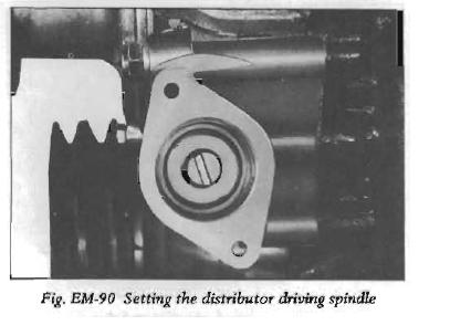

Also, the position of the rod that goes from the oil pump to the cam gear to the distributor is very important. The key for the distributor must be as shown in the picture at engine TDC. This will make timing easy. Make sure it is not 180 out.
Rich
