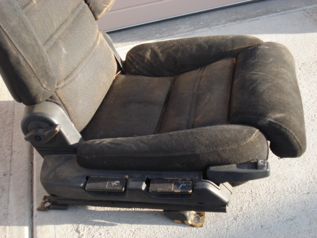

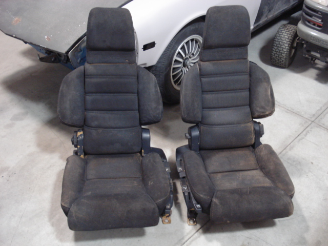

I picked these seats up at the salvage yard this afternoon. Found them in a '77 Porche 924, but they are not the original seats from that car. They did not use the stock seat mounts, instead there were holes drilled through the floor to mount these seats in the Porsche.

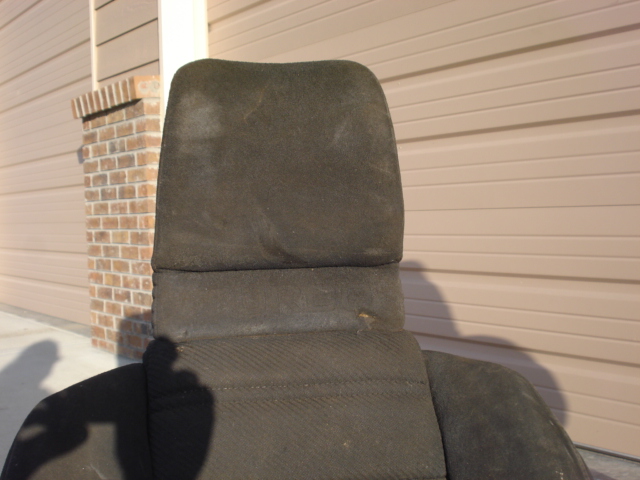

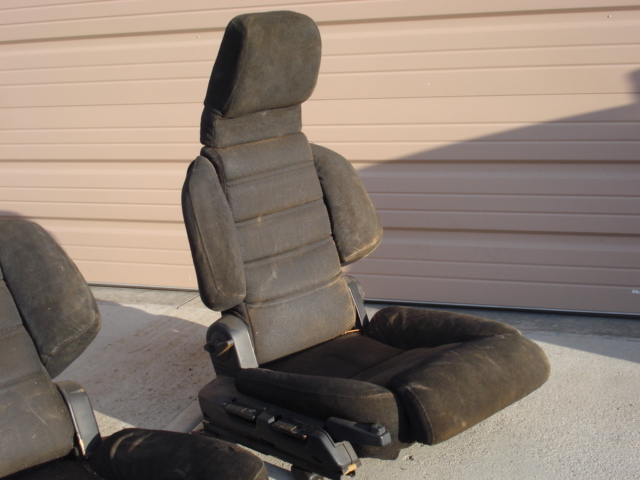

I've searched the photo gallery and also online, but haven't found anything exactly like these. They say "TURBO" beneath the head rest. There are two dials on the side, one for lumbar support and the other pulls in the upper side supports. There is also an adjustable thigh support (moves up & down).

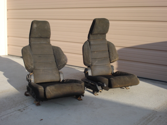

I set them in my project 240Z and it looks like they will work, although I'll probably have to cut out the stock seat supports. These should bolt right to the floor with a little work. They are comfy to sit in!
