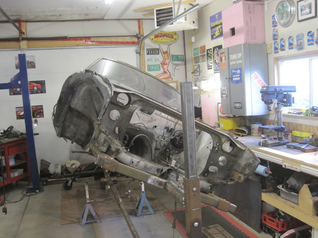

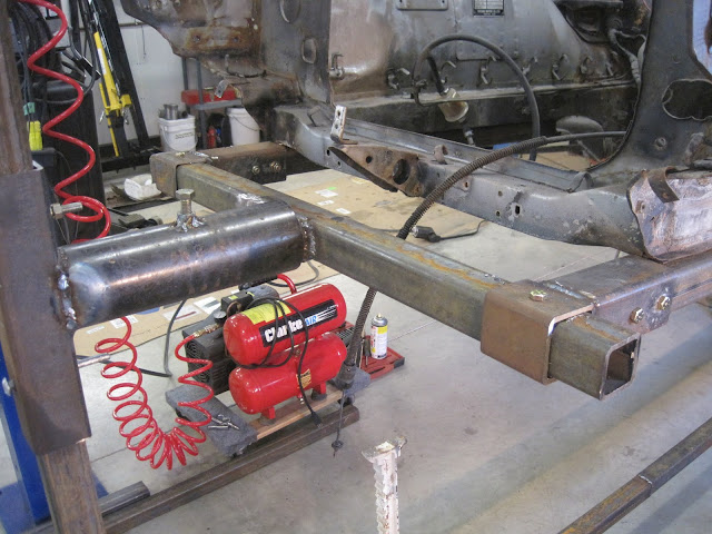

Built a rotisserie - and the 240 is it's maiden lift! I was going to go with the wooden tip-over jig discussed earlier - but my brain works overtime, as do my hands....so I found some plans and probably spent 200 X the time and the money to build this one...
And WALA!!! About 60 hours later....

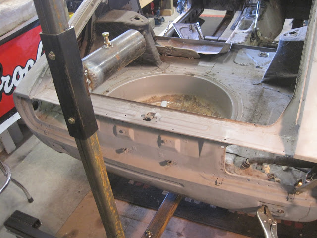

And now I can continue on the floors and inners. which you can see cut out here.
Nice! The trans mount or some other method of maintaining the tunnel width is a good idea to keep in place until the floors are welded in. How is the weight balance while turning the car? It looks to be a little on the roof heavy side.
