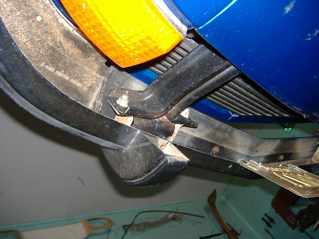

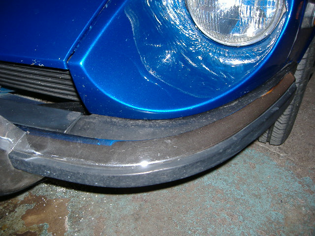

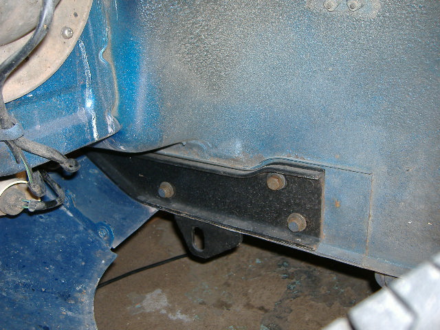

These should help. The brackets are heavy and mount to 3 capture nuts on the frame rail. Remember, the 73 had rubber inserts that made the bumper stick out further both on the front and the sides, last photo.

Thanks for the photos. That explained everything. I did get the correct brackets. What was confusing me was the "pipe" section where it bolts to the bumper. Your picture #2 shows it clearly. Also the previous owner had made his own brackets that bolted inside rather than outside.
