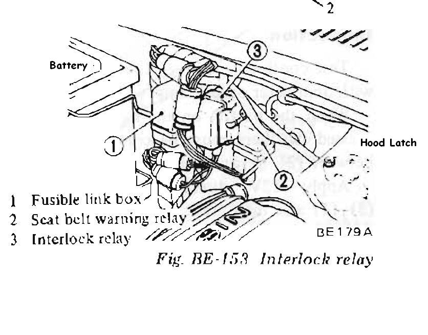

Hopefully you have the FSM. If not, you can download it from Xenon S30.
Also if you don't know where the fusible links are, the attached picture should help. Don't forget to check the condition of your grounds, too.
Assuming the battery has voltage, the fact that your lights aren't working would suggest you have a fusible link problem. I don't know whether the lights and the ignition key circuit share a fusible link in the 260, but if so, then I think that might be it.
