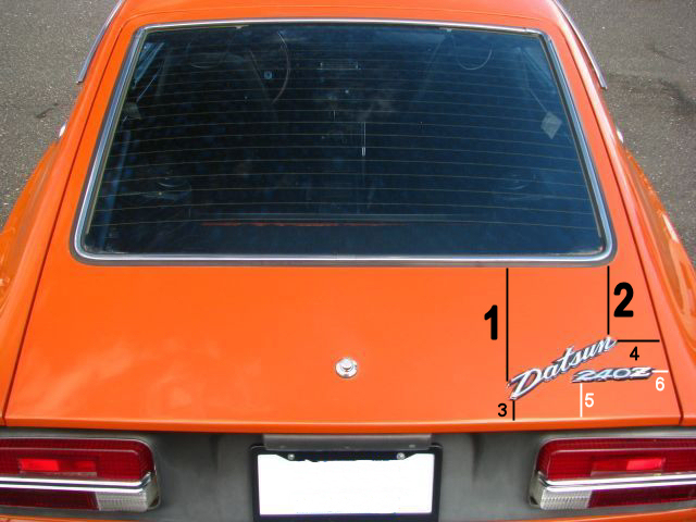

Posted July 20, 200915 yr comment_290008 Emblems on rear hatch removed by P.O. and holes are non apparent. Looking for the exact emblems position measurements (Datsun, 240z) Link to comment https://www.classiczcars.com/forums/topic/32584-rear-hatch-emblems-postion-measurements/ Share on other sites More sharing options...

July 20, 200915 yr Author comment_290011 Yes i have look and there is nothing distinctive. Nothing also in the FSM or any of the books that i have (How to restore...) I am almost done with my 73 restore and stuck on these little details, there must be some reference for this ? Link to comment https://www.classiczcars.com/forums/topic/32584-rear-hatch-emblems-postion-measurements/#findComment-290011 Share on other sites More sharing options...

July 20, 200915 yr Author comment_290032 If anyone could post these 6 points measurements, my Z day would be perfect ! Link to comment https://www.classiczcars.com/forums/topic/32584-rear-hatch-emblems-postion-measurements/#findComment-290032 Share on other sites More sharing options...
July 20, 200915 yr comment_290038 Yes i have look and there is nothing distinctive. Nothing also in the FSM or any of the books that i have (How to restore...) I am almost done with my 73 restore and stuck on these little details, there must be some reference for this ?I think I'd take another look - those holes weren't "self healing". There has to be evidence like Bondo squeezed through. Even if excess was wiped off on the underside of the hatch panel and painted over, you should be able to see something. Since my emblems are off, here are some measurements to the holes.Datsun:1st hole on left 8 7/8" down from rear window seal, 10 3/8" from right edge of hatch2nd hole:7" down from window seal, 6 11/16" from rt edge of hatch3rd hole:5 7/8" down from window seal, 3 3/4" from edge of hatch240Z:1st hole:8" down from window seal, 5 7/8" from rt edge of hatch2nd hole:8" down from window seal (seal starts to curve up at this point, so scribe a horizontal line along bottom of seal, 2" from rt edge of hatchHope this helps, good luck!Dennis Link to comment https://www.classiczcars.com/forums/topic/32584-rear-hatch-emblems-postion-measurements/#findComment-290038 Share on other sites More sharing options...
