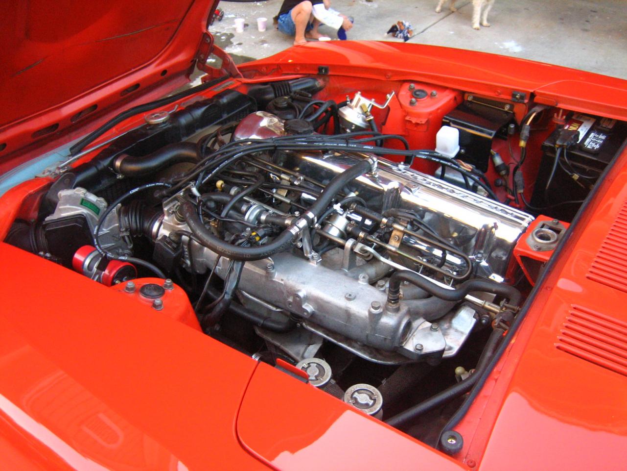

75 280. Engine seemed like it was running a little weak. Did the cyl by cyl pull the plug and injector test to isolate. #2 cylinder seemed to be the issue. Did compression test, that was about 90 PSI in #2 while rest were in 150 +/- range. Car does use some oil (blue smoke) when under hard revving, but not under normal driving. Does not leak. Temp runs fine. Oil press is fine. I was under impression if you had bad rings or valves the compresssion would be zero, not just down about a third. Anyways, would seem to explain why the engine seemed to have a little less power that before. Has 110K on it, very regular maint, oil changes, etc. I have owned several of these cars and 110K is usually not alot of miles.
My questions:
1)Does this sound like it's time for a valve job, ring job or both?
2) Are there other tests I can do to further ID the problem. Thanks in advance.
