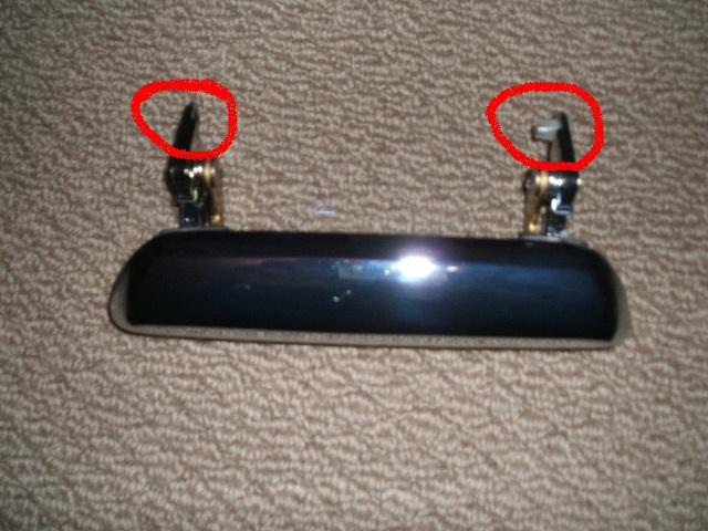

The same thing happened to my Passenger side door, i left it for years and years (to the point that i had auto locks installed and didn't pay for that door cause it wouldnt open) Do like five&dime said, the linkage can break away, or in my case break off all together, a junk yard will sell you a handle pretty cheap (i think i paid 8 dollars for mine) its two bolts on the inside of the door its not too bad.
You need to pull the door card off, then you'll see if there is a rod hanging down. If it has a bit of diecast metal on the end, you have a broken handle. Normally caused by a gunked up lock assembly.
My advise is to pull the entire lock assembly, soak it in a parts cleaner and re-grease it. Buy a new handle and put it all back together. It will be like new.
If you don't want to buy a new handle, you can always swap it with the other handle as they have tabs on both side. Only down side to that is it's twice the work.
Door handle part number is 80606-E4100.
