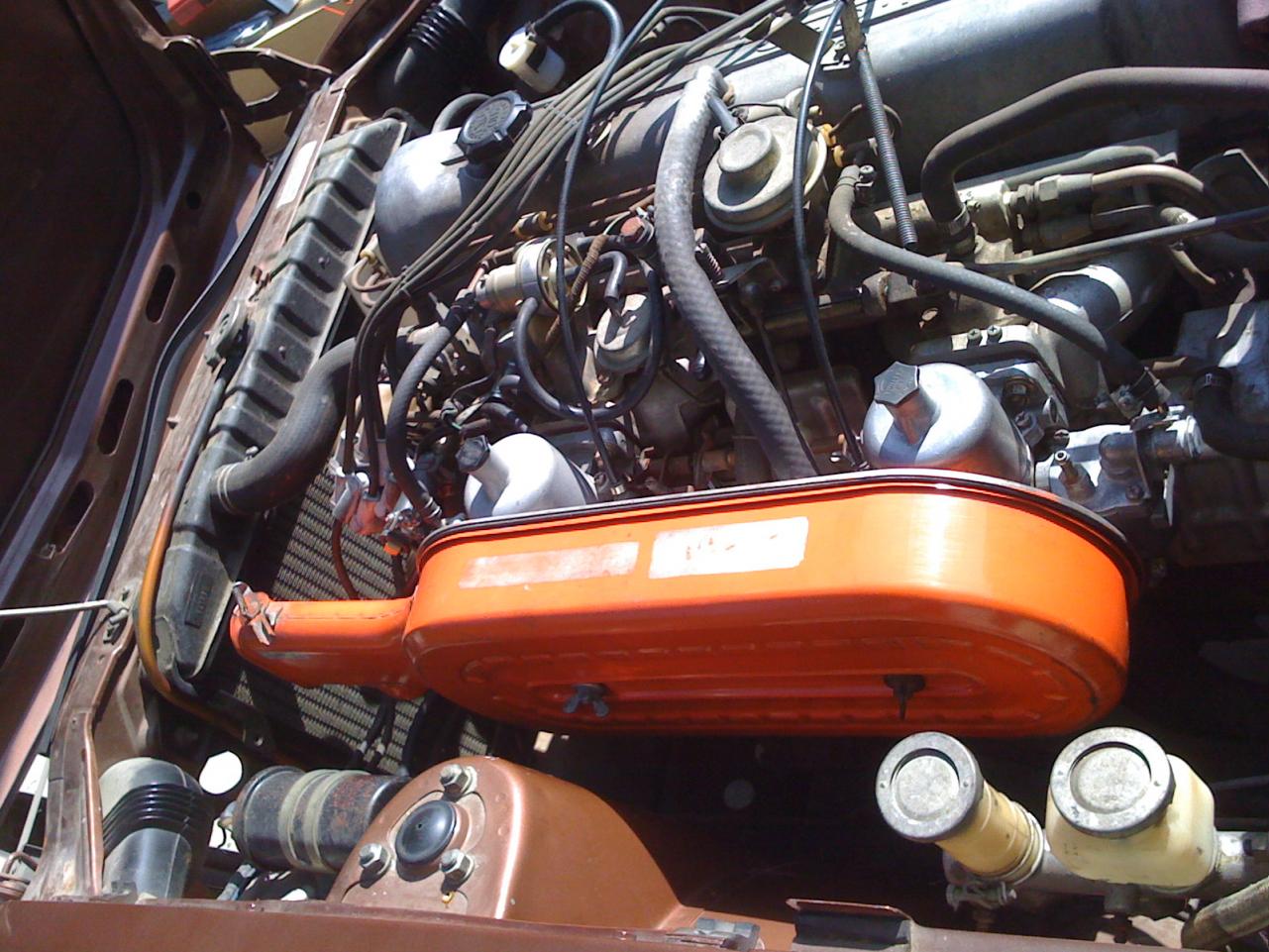

Latest news on the Z is I got the engine buttoned up and running pretty good. I'll need to borrow my friend's uni-syn before I can really say I'm happy with it (it's starting on the first crank!). The clutch master is toast and blowing bubbles into the reservoir (i may try to bleed it again but I'm pretty certain it's leaking internally). It'll need a new flex hose to the slave as well. The brake flex lines are in good shape but I found a wheel cylinder that leaked out. I was pretty exhausted by the time I hit the brakes today so I didn't pull off the front wheels. I am still pretty sure it's going to need a new brake master though... there is evidence on the booster that fluid leaked out. Oh, and I fixed my crooked windshield wipers :)

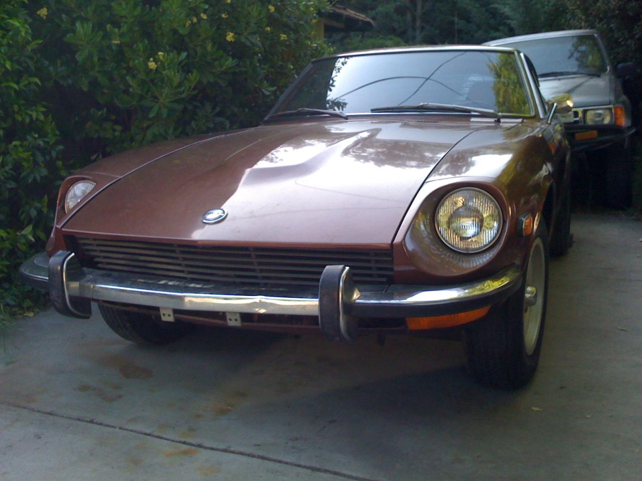

I like your pictures! I hate to copy you but it's cemented my desire to remove the vertical bumper bars from my car
