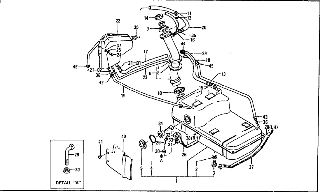

This should give you a clue...
As you can see there are 3 vents on the tank - all of which go to a Gasoline Vapor Recovery tank - that tank is then vented via #46 to the front of the engine compartment.
No - the gas cap is not vented. It's a sealed system to keep gasoline vapors captive.

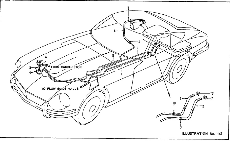

Here is a diagram of the stock fuel system for a 240.
You may want to check what pressure your electric pump is putting out, anything over 5 psi will not be helping you 3.5 psi is more ideal. Are you still running both fuel pumps? I'm not sure if the mechanical pump will like receiving fuel under pressure, someone with more experience will have to chime in with that.

Thanks Carl, so from the picture i am guessing the vent line ends up near the smog pump on the left side of the car? My smog system is inoperable so I guess if it were to be plugged it would be somewhere around there or should I look at the purge tank first?

There is a fresh air/vent line that runs from the gas tank to the evap tank. It exits the tank just above the sending unit for he fuel gage. Then it exits the Evaporation Tank , evap, and goes forward to the driver side of the engine where it is attached to a three way valve , Brass and it has one inlet one exit to the air cleaner and another attaches to the breather coming out of the engine block. These are all about 3/8'' hoses. What the brass valve does is it allows air to flow into the gas tank from the clean side of the air cleaner, and then when there is pressure in the gas tank from expansion on a hot day, it vent into the engine. So look for a small hose back above the sending unit. By the way , your Z is already wired for a electric pump back by the tank. Follow the wires going to the sending unit back up toward where it comes down from the floor. Find a couple of wires one green and one black , rolled up and taped with blue tape . This is what they are for. Black is ground.
Gary
Ok guys, thought I would report back to you. I found the 2-way check valve to the left of the air cleaner housing, I took it off and when I pulled the line off that goes to the tank it pulled in air :D The check valve did not operate when I blew/sucked directly on the valve, a little bit of carb cleaner and a few minutes later the check balls were working as intended. I went for a drive and everything works just fine now :)
