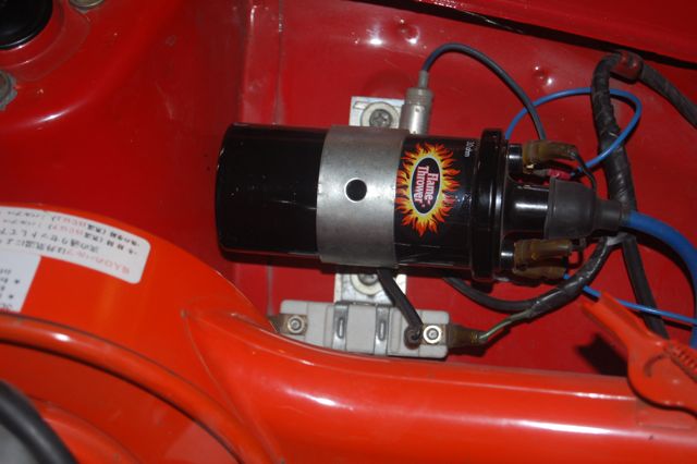

My resistor is bypassed, but still mounted in place. And I'm using a Pertronix coil, but it is mounted in the factory coil bracket. As Gary noted, the resistor is mounted horizontally, just under the coil. It mounts using the same bolt as the lower ear of the coil bracket - it just bolts in place, doesn't 'clip' to it in any way.
I can't find a picture of that part of the car right now - I'll try to remember to grab the camera and post one after I get home this evening.
As promised...
