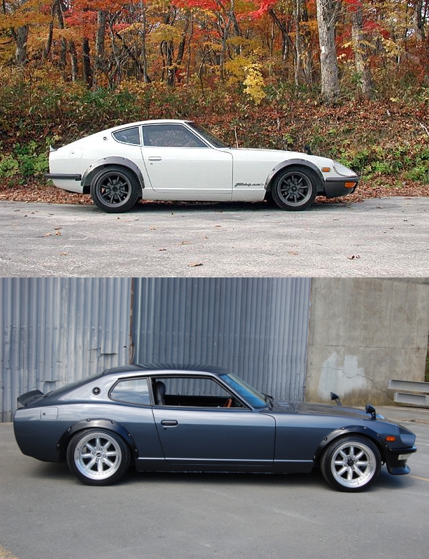

I don't know very much about the 2+2s but the S30's are in fact a good deal longer, as evidenced by the broken roof line. Datsun most definitely didn't just throw a back seat into 'em. Check out those quarter windows and the panel following the door too.
I've attached a comparison photo. Coupe on top, 2+2 on bottom.

I believe S30 2+2's were available from '74 on. They're essentially a s30 Coupe stretched 12 inches to accomodate a rear seat, mechanically identical except for the driveshaft length. I think the doors may have also been stretched, but I'm not sure.

In the U.S., the 1974 260Z was offered as a coupe and 2+2 , the 75-78 280Z's were also available as a coupe or 2+2.
In the 2+2 car, the tool boxes found in the coupes were deleted and small seats were installed. The back of the rear seat folds down over the seat cushions. This make for some convenient package transport.
The 2+2 is about 11 1/2" longer than the coupe. The doors are longer and so is the space between the rear edge of the door and the rear wheel arches.
The qtr windows open in the 2+2.
The 2+2 weighs about 300 pounds more than the 2 seater.
IMHO, the 2+2 car can look very nice in certain colors. It looks terrible in brown, but great in grey, green, and orange.
The rear finish panels are longer on the 2+2, and the rear of the car is 3/4" wider than the coupe. Bumpers are wider (longer) too. The bumper end caps are different some how, but I have never figured out how, other than part numbers are not the same.
The rear hatches are not the same. The hatch windows are not the same shape/size.
Front windshield part numbers are not the same, but I have read here or somewhere (by TonyD, I think) that the front glass will interchange.
Suspension in the 4 seater is rated for the heavier car with a 4 person payload. The Rear Sway bar in my 2+2 is 1 1/8"!
