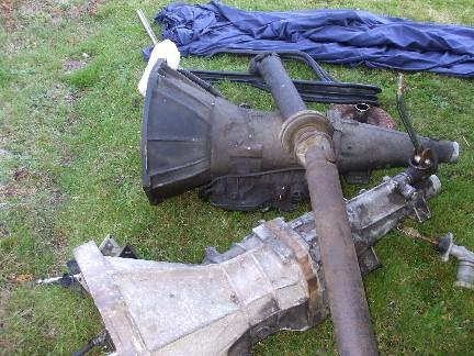

How about these two trannies? The top one is an automatic and the bottom one looks to be a 5 speed from a truck, but can it also be used in a Z car?
-Mike
I know what pair you are looking at, Mike, and the price is right. Sell the auto to that outfit down in CA and you're golden. If they were down here I'd already have them.
I believe the truck tranny will bolt to any L-series motor, but that the truck ratios may be a bit wider than most Z owners want.
If it's a 620 trans it's the same length as a S30/S130 trans. If it's earlier or later i.e. 521 or 720 it will either be too short or tilted wrong.

Yep, that was my plan Arne. I don't need the five speed, but if anyone does they could have it very cheap.
