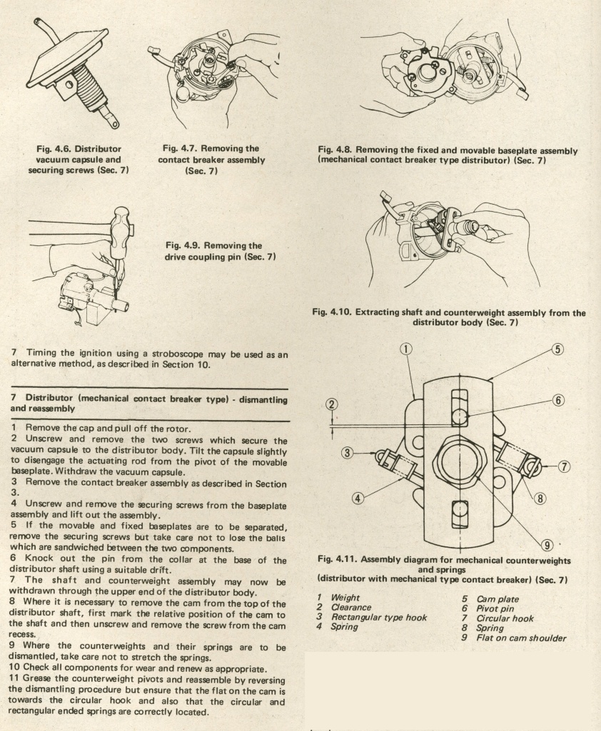

Be very careful if you separate the moveable and fixed plates, there are tiny ball bearings between them to allow the plates to rotate in relation to each other
Extract from the Haynes Datsun 240/260/280Z Repair Manual, page 76: -
Thank Graeme,
