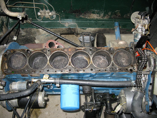

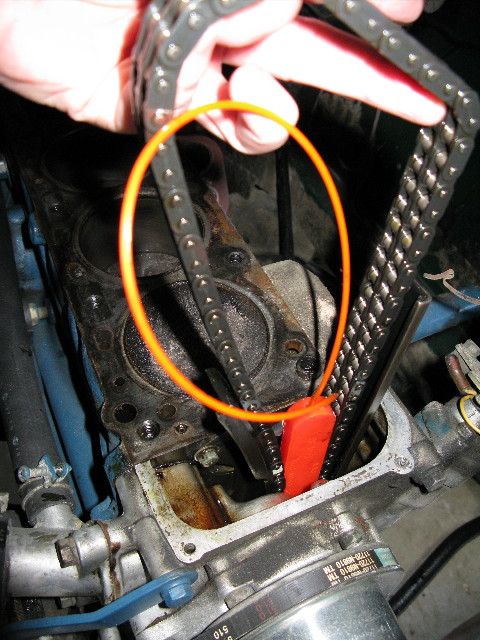

I've attached some pictures for help. Number 1 and number 6 pistons are fully up. You can see the white link in the picture next to the orange tool on the left.
I'm thinking that when I put it back together I'll put the chain on the sprocket in the best fit possible. I may be off a link or two. Then, without the head bolts, I'll turn the crank until I eventually get to where the white link is at the top, #1 piston is at the top, and the groove and line on the sprocket match up.

At one point I had the cam sprocket in the right position (line and groove matched) and the link with the white mark was at the top of the sprocket. I messed with the engine after that, but thought I had it back in the right position.
You probably did not re-align the mark after messing with the engine. The white mark is "behind" the chain wedge. There is no way for the chain to slide behind the tool with the tool in-place. You'll know if the chain slipped and the tensioner popped out because you will not be able to install the chain on the cam sprocket.

This has happened to me in the past. Couldn't understand it. But there is some logic to it if you stop for a minute to think about it. The bright links on the chain are not exactly the same number of links from each other.
An example: Say there are 50 links total in the chain, and the bright links are separated by 17 links. Turn the thing over and it will take a while before all the 'bits' fall back to their respective positions. It would happen much more often if there were exactly 25 links of separation....do you follow?
Get a bicycle and experiment with the chain and mark two links with paint and make sure they are separated like the example above. Give it a go and you'll soon see what is happening in your engine.
Bottom line, doesn't line up with the bright links...who cares? So long as all of the other setup criteria is met, TDC, rotor pointing the right way, timing sprocket notches etc, you'll get it to run again properly. :classic: (Or you could have turned your motor when the head was still on with only the rocker cover off until the links were where they were 'supposed' to be).
