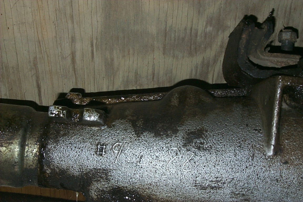

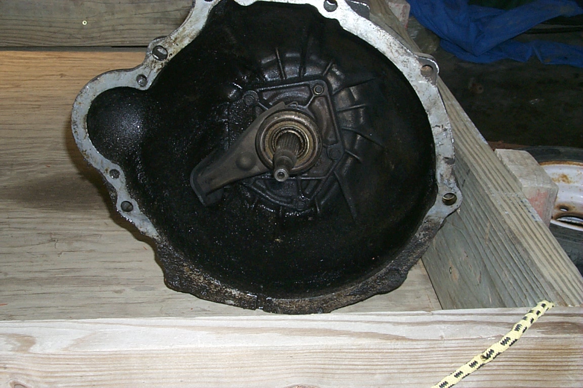

1. Aluminum 5-speed transmission. Bellhousing does not match up well with engine, only bolted on with 4 bolts plus starter bolts. Has the number 60 by shift lever connection, and # 9_2_28 near rear of the transmission. There do not appear to be any other numbers on it, but I haven't scrubbed all the grime off yet. Weight: 120 lbs. Any transmission experts out there?

Looks like a standard Nissan 5 speed to me. They are aluminum, and only attach to the block with 4 bolts and a sandwich plate between them. As far as I know, the numbers cast on the tranny don't mean anything useful.

On the tranny, is there any easy way to find out what year it came from? I'm looking for the close ratio'd 1-3 5 speed.

Yes, there is an easy way to find out which 5 speed it is. If you search thoroughly enough, then you will find it. I'll be nice though, the earlier 5 speed has two "ears" on the tailhousing, below the shifter lever. The later, close ratio transmission only has one "ear" and it's on the driver's side.
Here, check out the pictures of a "uni-ear" here to see what I'm talking about for yourself:
http://www.geocities.com/jasonparuta/gearbox.html
I don't recall where I got this from but it shows the differences a little more close up.

My records seem to indicate that the both the 4 speed, and the late, close ratio 5 speed I installed later only weight about 70 lbs, so the 125 seems high. Just an estimate perhaps? I noticed that they were really light, so I weighed both of mine.
