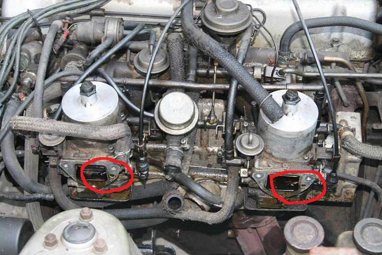

Over the last few days I have cleaned out the tank and lines, fuel filter, oil etc and went for the first start just a moment ago. The car fired right, but took 8-10 tries before it was ideling.
I have not attached the air filter yet so I noticed when it was running gas was coming out of the area I circled in Red on the carbs. Is this normal? I fully admit I'm still learning on the mechanical side so I'm not sure if this is a normal function or if the gas should be going somewhere else. I was concerned that if the exhaust got hot all that dripping would help remove my eyebrows.....:stupid:

Fuel coming out from any area other than going into the motor is probably not good. Sticky floats or maybe just typical for flattops like those.

Doubtful typical for flattops. The needle/valve mechanism to which the float attaches is stuck open (dirty needle valve, needle valve seat, binding of the float mechanism, damaged float etc) allowing the float bowl to fill above the level of the nozzle in the venturi. Or (per the 1973 FSM EF-18):
-Excess fuel pump pressure
-Fuel pump drawing in air
Although I have a '72 with round tops, I would guess it's what xray said. I just had a similar issue whereby the float wasn't closing the needle valve, causing spillage from the over flow tube/outlet.
Randy, do you have a copy of the '1973 240Z Fuel System Modification Plus Program' reference? The last 20 pages or so of it deal with the fuel pumps and carbs.
