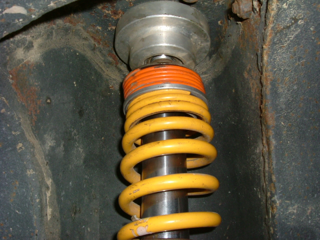

Interesting that you mention this. Whatever springs that were put on my newly purchased Z are amost completely bound. It seems that I may have at max 2" of compression travel. Those will be replaced soon.
The lack of compression travel has to do with how much your car is lowered. Keeping the same spring and shortening the strut will get you back some of that suspension travel.
Lowering a 240Z any more then 1.5" requires strut shortening IMHO.

Is a coil spring, with "0" clearance between the coils really a "spring" or is it just a "coil of spring steel".
Is it possible that someone has heated these springs, to let them collapse? Maybe to lower the ride height?
Eibach sells progressive springs, and that's what is pictured. It is true that there are hillbillies out there that will lower their vehicles by taking a torch to the spring, but that's not what we're looking at here. In terms of the spring function, yes, if the coils are bound then they aren't doing anything. But when you're actually driving the suspension doesn't just compress, it also extends as the wheels go down into depressions in the road, etc, and when this happens those springs will open up a bit and that will lessen the spring rate for the first part of the travel. If the coils didn't bind at some point, then your spring wouldn't be "progressive". It would just be a lighter weight spring.

In regards to the springs being ok either way.... That is incorrect. When we did my dad's car, we installed the eibachs upside down. Turns the Z into a truck. When we flipped them, it was low (correct).
Always install springs with the writing right side up.
That don't make no sense. ;-) To what do you attribute difference?
Spring rate is determined by the wire size and number of coils, and has nothing to do with which end of the spring is up. The springs act exactly the same, the only difference is the increase in unpsrung weight with the tight coils on the bottom and a slightly higher cg with the tight coils on top. Those things are both very minor differences, and if one was going to have a greater effect, it would be the unsprung weight. Reducing the unsprung weight would make the suspension more reactive to bumps in the road and would allow the shocks to have better control over since there would be a very slightly lighter mass to damp.
I'm with Jon on this one. The ride height can't be affected by whether the springs are upside down or not. I say this not only from theory, but also from several years of experience selling and installing Eibach springs. I've done them both ways - no difference.
