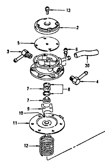

So I think the next step is to take the inspection cover off of the fuel pump and start the car to see that the valves are opening/closing. I do know the pump rocker arm is up against the eccentric, I checked that when I re-attached it.

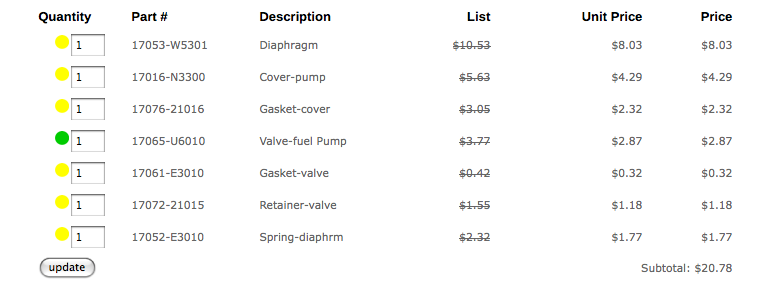

I did check to see if the mechanical pump was working (ran hose to a can) - it looks like that's the issue.
Someone suggested AutoZone - they have an "Airtex Master" fuel pump that apparently fits. Looks much different from the OEM unit, but at $37.99, it's much better priced than what's at Black Dragon.
Anyone have experience with "Airtex Master" and/or AutoZone?
