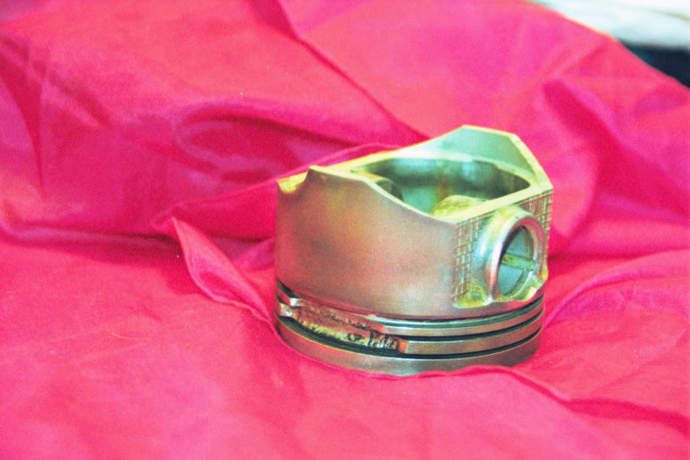

I never expected to see this when I pulled it out. I knew I had a dead cylinder but I wouldn't have guessed it this bad.
What could have caused this carnage? All the PO told me was "yeah, she misses a bit..."
Ya think?!

So any guessing as to possible reasons? Maybe there is something that I'm missing that might cause this to happen again. Thanks!
Usually, caused by severe detonation and/or uncontrolled boost:rolleyes::rolleyes::rolleyes:
Was the engine boosted or not?
Pic. shows a piston from the engine of a Nissan N14 Pulsar GTiR which was driven with the Electronic Boost Control "inadvertantly" disconnected:ermm::ermm:
Oh, that piston will need replacing:nervous:
Ya, that would be the problem. How do the rest of them look?
Well, as far as I know it wasn't boosted. Everything looked bone stock when I got it. The rest of the pistons look great. No scoring or anything. One thing odd though, the cap at the connecting rod end of that piston was on backwards. Don't know if that would have done anything. Obviously the engine has been worked on before...

Classic detonation failure. If it wasn't boosted or on the spray, then the CR was too high for the fuel grade.
An F54 block and N47 head combo will give you about 10:1 CR but only if the head has not been shaved. Either the head has been milled and/or the PO ran too much spark and not the right fuel. I have the flat top/N47 combo and have zero problems with detonation. My head has not been milled and I run a Nissan head gasket which gives me just under 10:1 CR. I use only 93 octane gas and made sure I had enough fuel based on spark plug readings. I ran the car at various engine speeds and shut it down, coasted to a stop and pulled each plug to check the color. I fine tuned it with a potentiometer in the water temp circuit (see Blue's site). Someday I will put it on the dyno and tune it right, but for now it looks pretty close.
