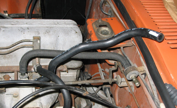

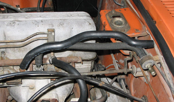

I know that the hose is NLA and no one even MSA or BD carries any longer for the 240Z. S I bought one from Ebay from a user than sells a lot of Z stuff, I asked if it would fit as it looked like it had more bends in it than mine had and I was reassured it did.
I figured that at worse case I would have to relocate the spot where it connected to the engine, but now that I have it I can't see where it would go.
Below are pics:

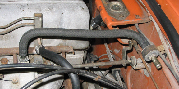

First is of the current hose that came with the car

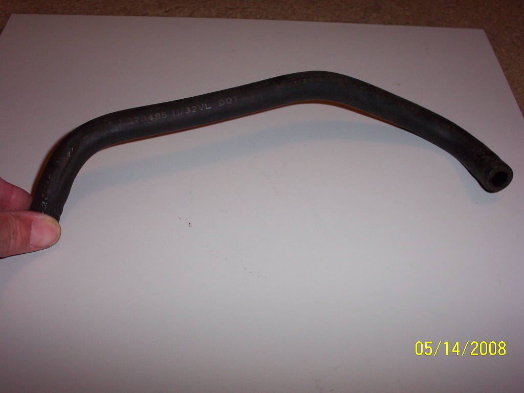

Second is of the new hoselaid next to the old hose

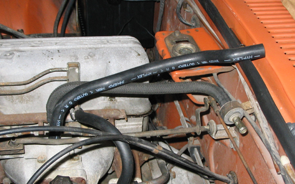

Third is of seeing how it would go if I moved the pick up to the spot in front of the current one

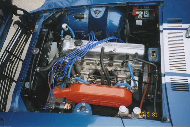

Fourth is of putting it where I have seen other Z's with it
but as can be seen it just doesn't seem to fit anywhere, the seller just said to turn it around but the hose doesn't have the right angle bends on both ends that seem would make it work properly.
Any ideas/comments such as where to get the right one, or if by chance someone has made this one work.
Thanks

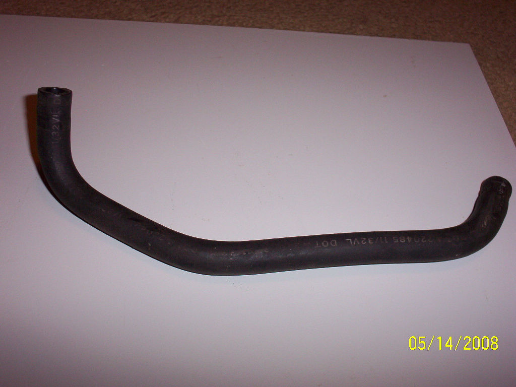

Gus, I think I have what you need. Check the pics and let me know if it looks OK. If it is, I will send it down to you. Just email me your street address.
Gus, I believe the one you want should have a 90 degree bend at both ends, and the orientation of the two bends should also be at 90 degrees to each other. Between the bends it should be straight, no curves.
That looks like it is it George, I will pm you my address.
I agree that is what it looks like Arne, and I have no problem with relocating the pick up if another version of the hose was all that is available and the seller confirmed it was the only one available and had superseded previous versions but this one I got is not even close, I could probably cut it and make it fit somehow but that is not right.

Your stock setup looks like mine from memory ...... simple hose with (2) 90-deg bends. The one you purchased is aftermarket and is definitely not the right p/n. E-Bay guys do get confused and frequently say things to sell parts.

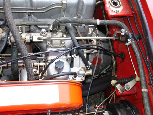

My memory was correct that my original braided hose was same as you show in picture. It failed trying to remember what is on car today!
I replaced the hose years ago and the new hose looks very similar to one in George's photo and it does not have braided outer casing but I did buy it through Nissan. It does have an extra bend in it and I hope it is not installed backwards??? My photo library got me aligned with reality. Here is current hose:
yeap George's looks like yours with the little extra bend so it should work
There were 2 balance tube / hose configurations, an end tap and a top tape. If a problem exists finding only one hose, finding the orther balance tube would be the way out......
