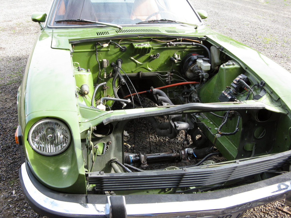

Good luck, let me know how it goes. Tomorrow I put some Rust Bullet on a few spots in the engine bay. And then get it ready for some touch-up paint. By mid week I hope the be putting the l28 into my 240z
