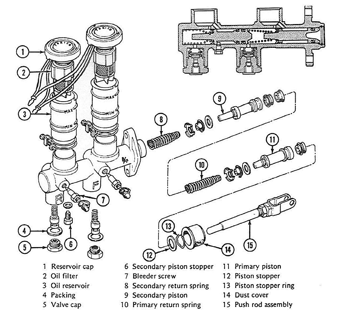

Sounds like you got a bad master cylinder. If your're getting front brakes, the push rod is moving both pistons in the master cylinder. The problem must be with the secondary piston (rear brake; farthest forward) either the seal or the return spring. Disregard the wired caps, this scan if for a 78:
If the secondary piston (rear brakes) of the master cylindar was shot would that keep me from being able to "pump up" pressure in the brake system when the engine is off?
I guess the easiest way to tell would be to exchange the MC for another.
-Terry
pretty much. If the front brakes are fine, and the front piston in the master cylinder is shot, then the fluid will bleed internally and it'll never build pressure. I know when the rear piston went out (front brakes) if i jammed on the brakes it was solid, but then the pedal would sink to the floor as the fluid bleed past the seals.
