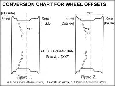

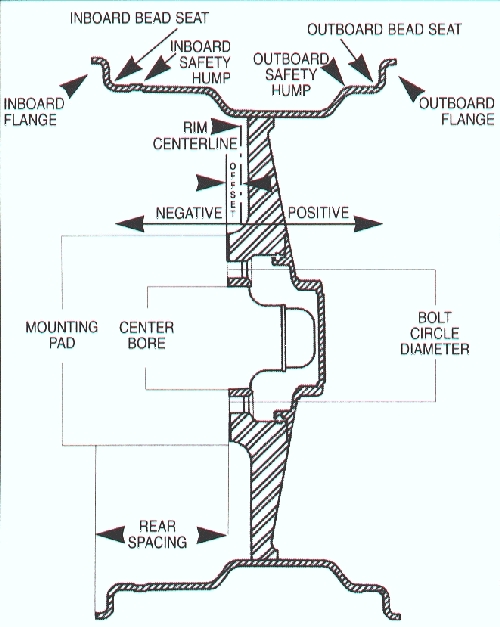

Here are a couple of charts which help explain OFFSET and BACKSPACING.
You have to realise that as the rim width increases, the above dimensions may also have to change, to position the rim away from: -
A] suspension components on the inboard side and
B] wheel arch/body work on the outboard side.
Don't get a set of wheels without knowing all these dimensions and applying them to your suspension and bodywork, or your current wheels:classic:
