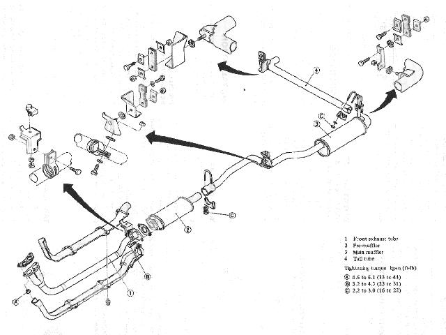

Here are the changes made up to and including 1975. I only see 1 mounting change. In the first illustration, the mounting points are C,D&E. For the 1975 280z, the forward mounting © was moved from the center tube to the front tube and was mounted to the transmission. I haven't found any info for the years following 1975.

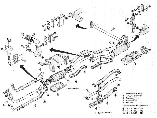

Any diagrams for the S130 280zx?
the mounting and layout described in those images are exactly the same as the mounting/layout on my 78 280z, which is the original exhaust that the car came with (muffler is stamped 6/78, same build date as on my vin plate)
so I don't think they made any other changes after '75
That's what I said:
From what I've read and seen, there were no other changes after 12/74 through the end of 280Z production.
But am I correct, in looking at the ZX scan, that the ZX exits on the right of the car as opposed to the left side as on S30's?
The turbo models exited on the left side, as did the later NA models, though I don't recall which year it switched.
