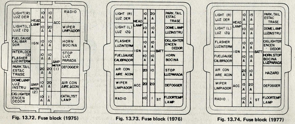

I have a 77, unfortunately I am onboard a ship right now on 1/2 hour Search and Rescue Standby - going home during the winter months is iffy. However I can tell you that a Datsun 280Z shop manual will be a great help for many issues, can't go wrong buying one. If I do get home I'll get a shot of the fuse box cover.

And if you do get that picture you would be a lifesaver :)
Fuse box covers.

I just wanted to thank everyone for the quick feedback. the fuse diagrams are a huge help. we are now just awaiting the hazard switch to see it that can help.
