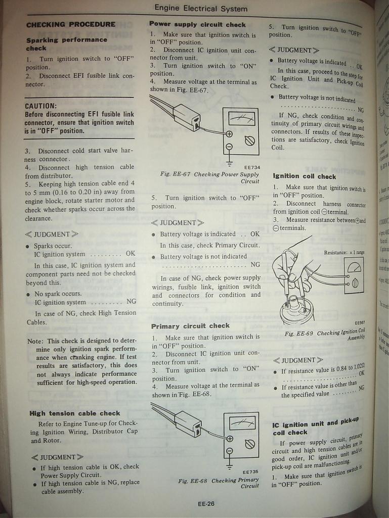

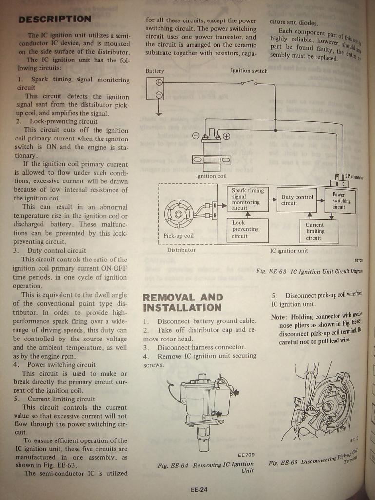

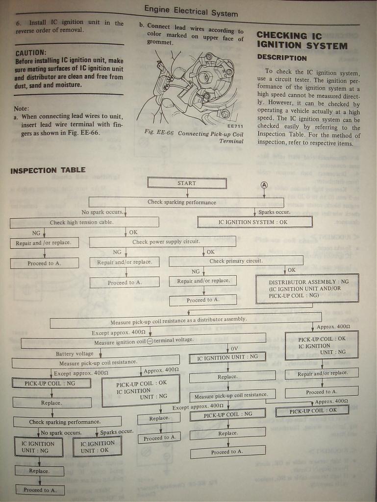

Any suggestions? Any way I can test the ignition control module?

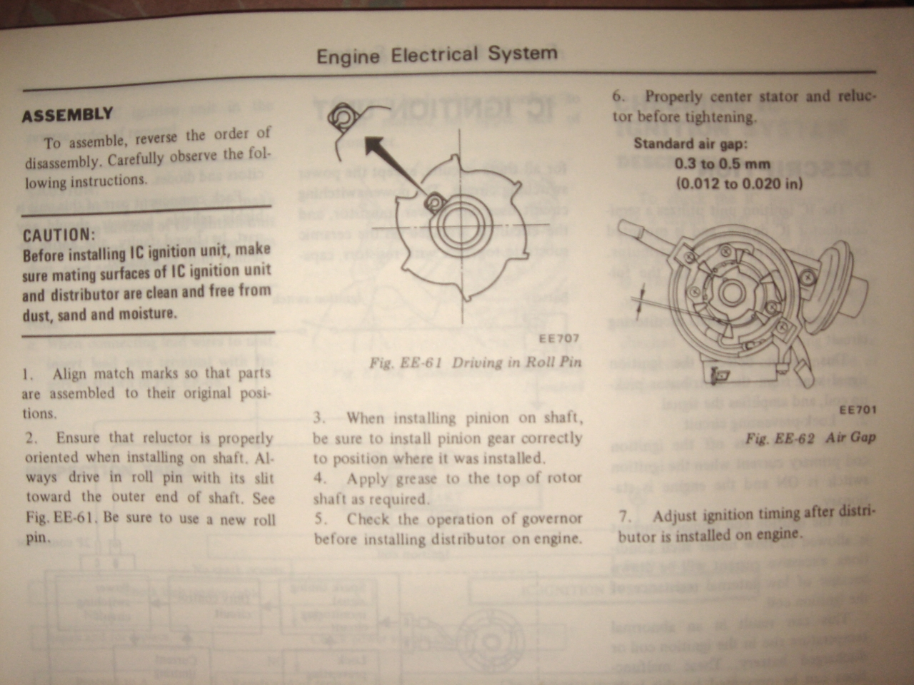

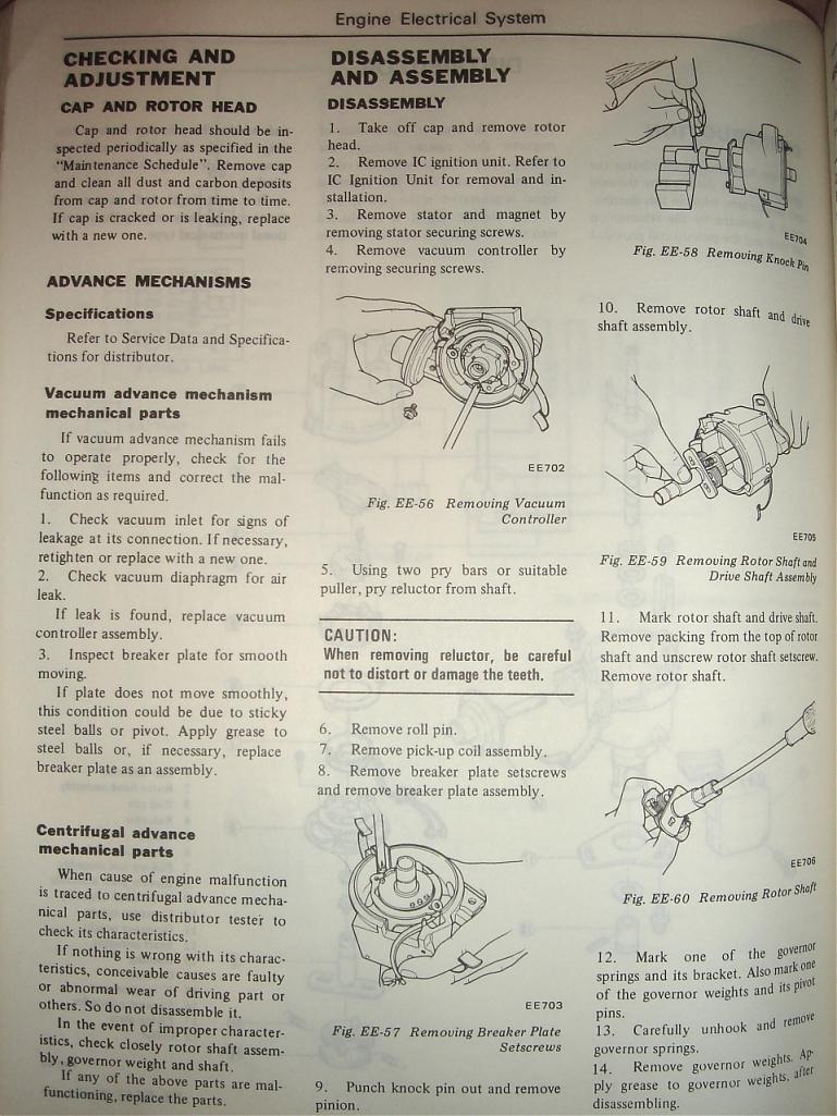

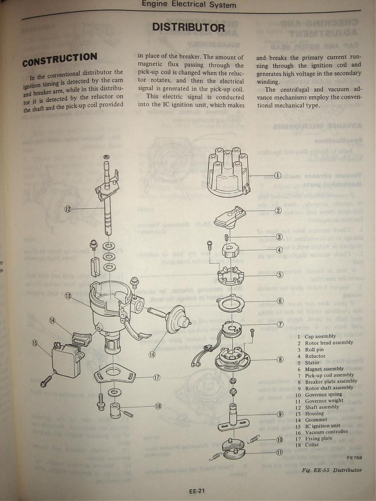

Zbane- Thanks for the scans!! Im sure they will help.
