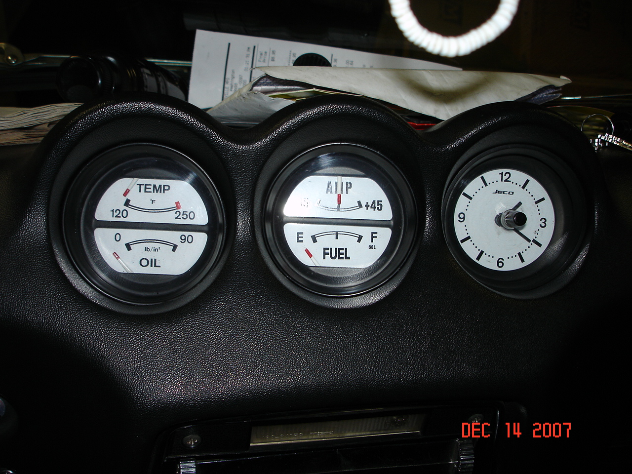

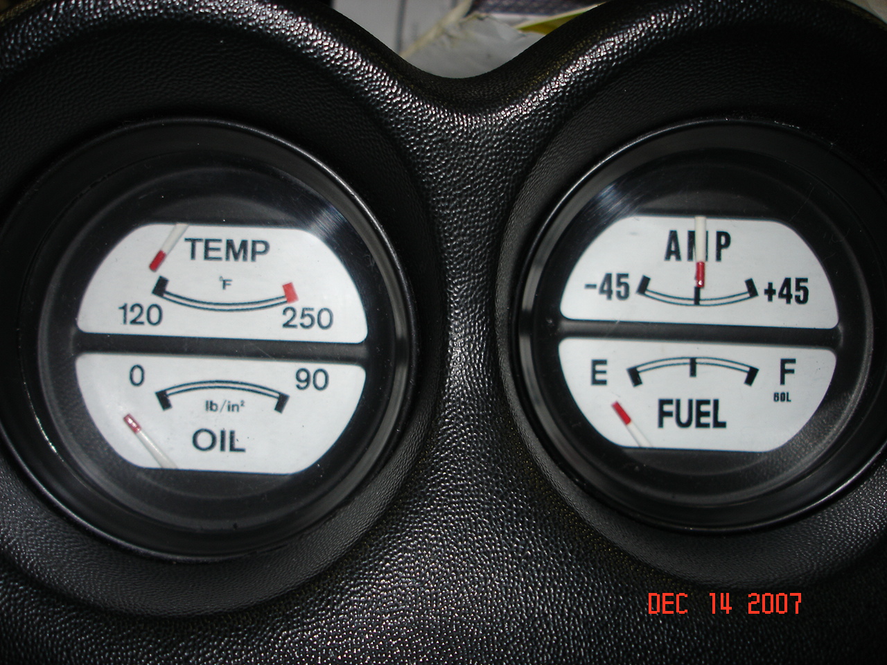

Today, I instal the kit on the temp/oil gauge, followed by the Amp/Fuel gauge, then I get to the Usual NON-working clock. I go to the local Value Village and buy 2) AA battery operated small clocks. I tear the smaller of the 2 down and build a battery operated clock into the Z's clock. Looks and works beautiful, battery sits back behind the fusebox area.

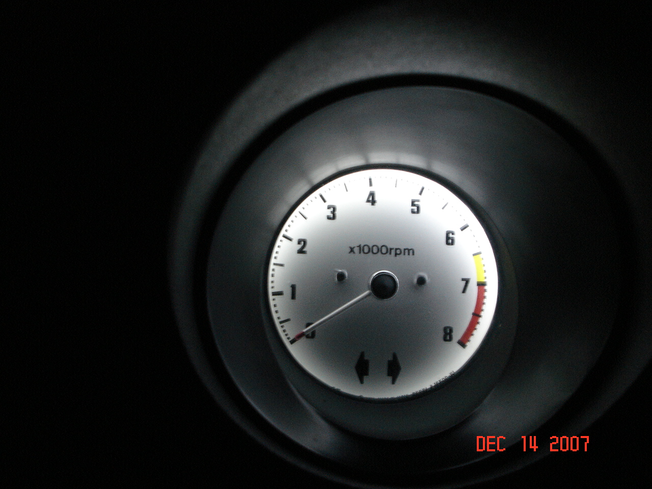

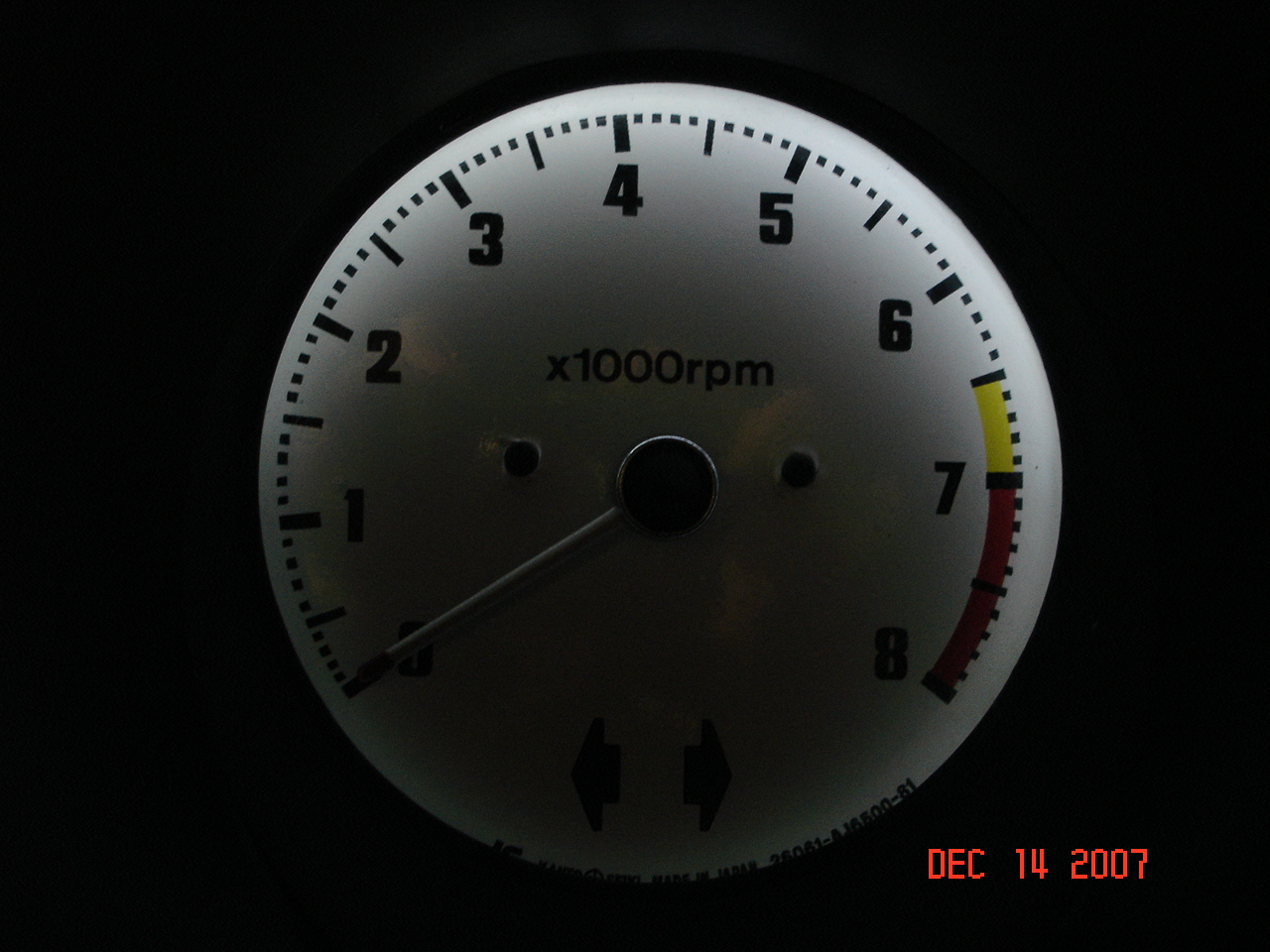

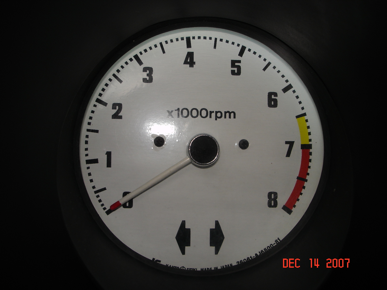

So I tear the Tach out, dissasemble it, paint the back of the face with chrome paint, go to put the Vinyl sticker on and find it's off a smidge. So I line up the mounting holes and tweek it just enought that 0 to 1000 RPM's is dead on. The rest is off a little but it ain't brain surgery and we're talking.5 to 1.5 MM, depending on where ya look.

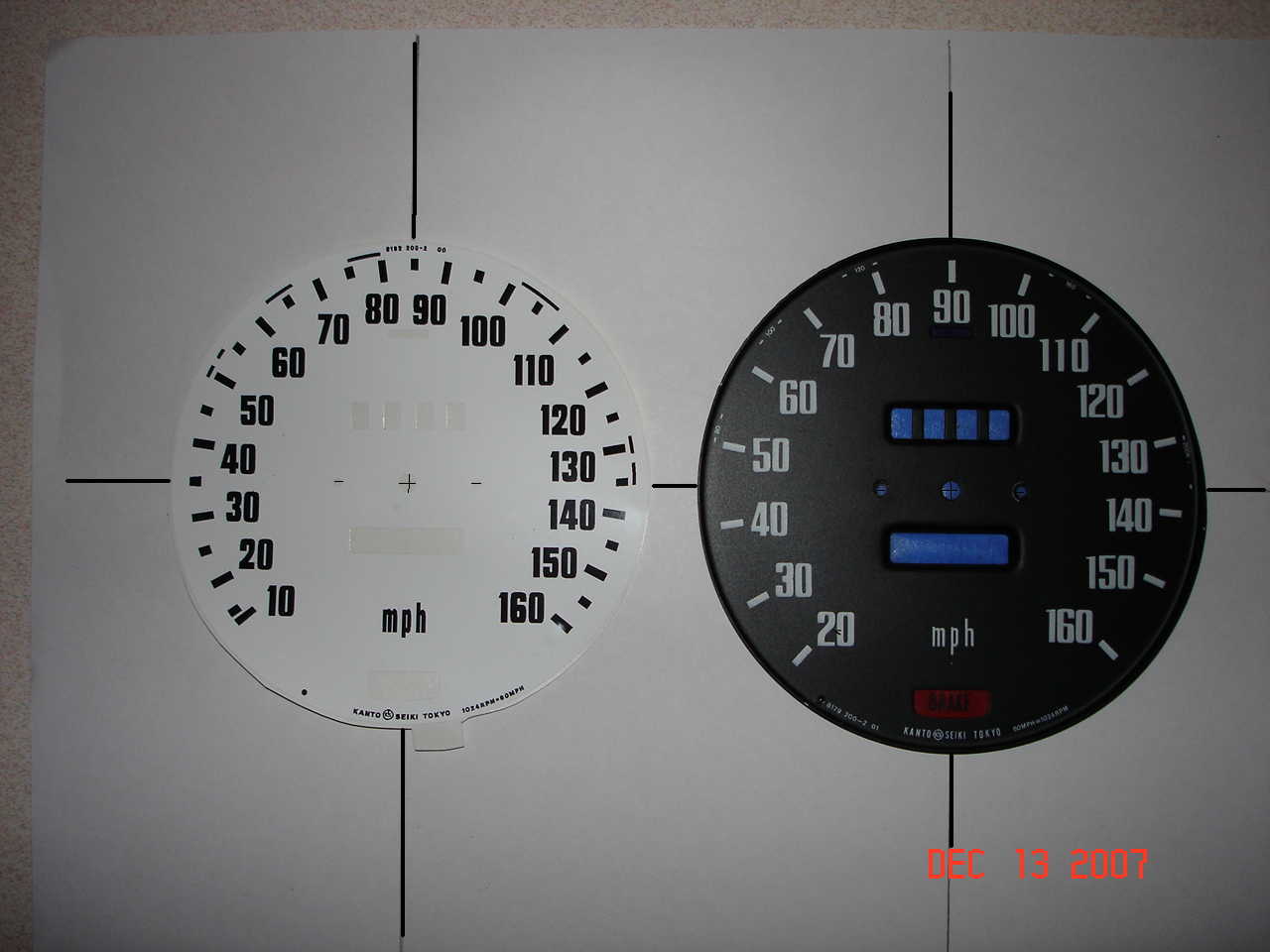

ON TO THE PITA. (pain in the azz) I put the tach back in and move over to the Speedometer. Tear it out, tear it down, paint the back alcohol swab the face and get ready to instal the white face and Vhoola.... WRONG.
The 90MPH mark on my face matches the 85MPH mark on the white face. My Speedo starts at 20MPH, the white face starts at 10.
So the question is...... Does MSA have the Correct face for the 20 to 160 speedo. Dead center above the "HI BEAM" light is 90MPH.
ANyone deal with this problem yet. I've done all the other gauges and they look AWESOME!!!!!! I just need one more gauge to finish the Much Brighter gauges.
HELP.......
Dave.

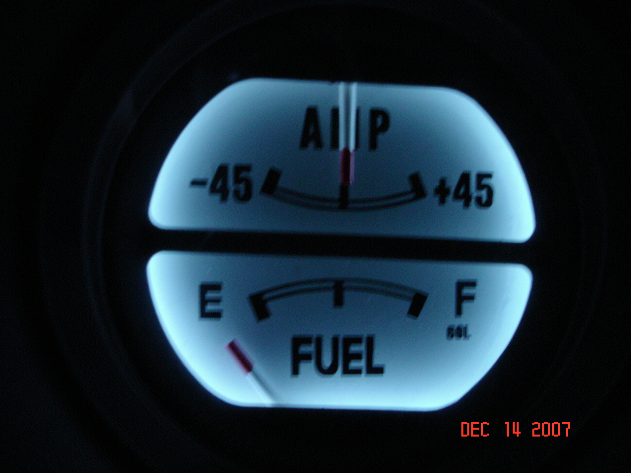

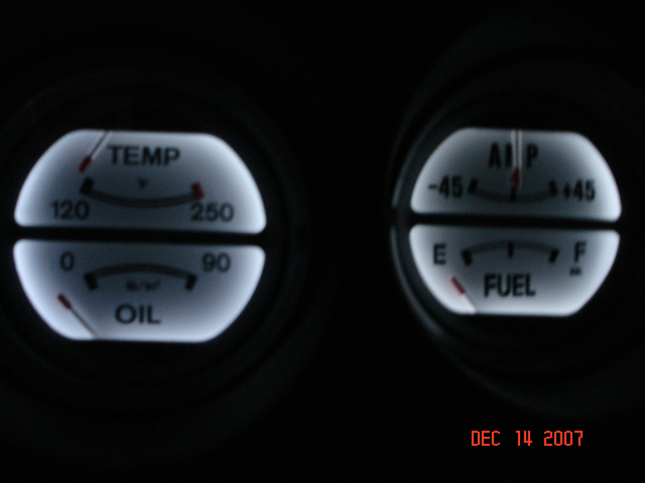

Pics below are lit garage, garage lights off - parking lights on close ups etc.

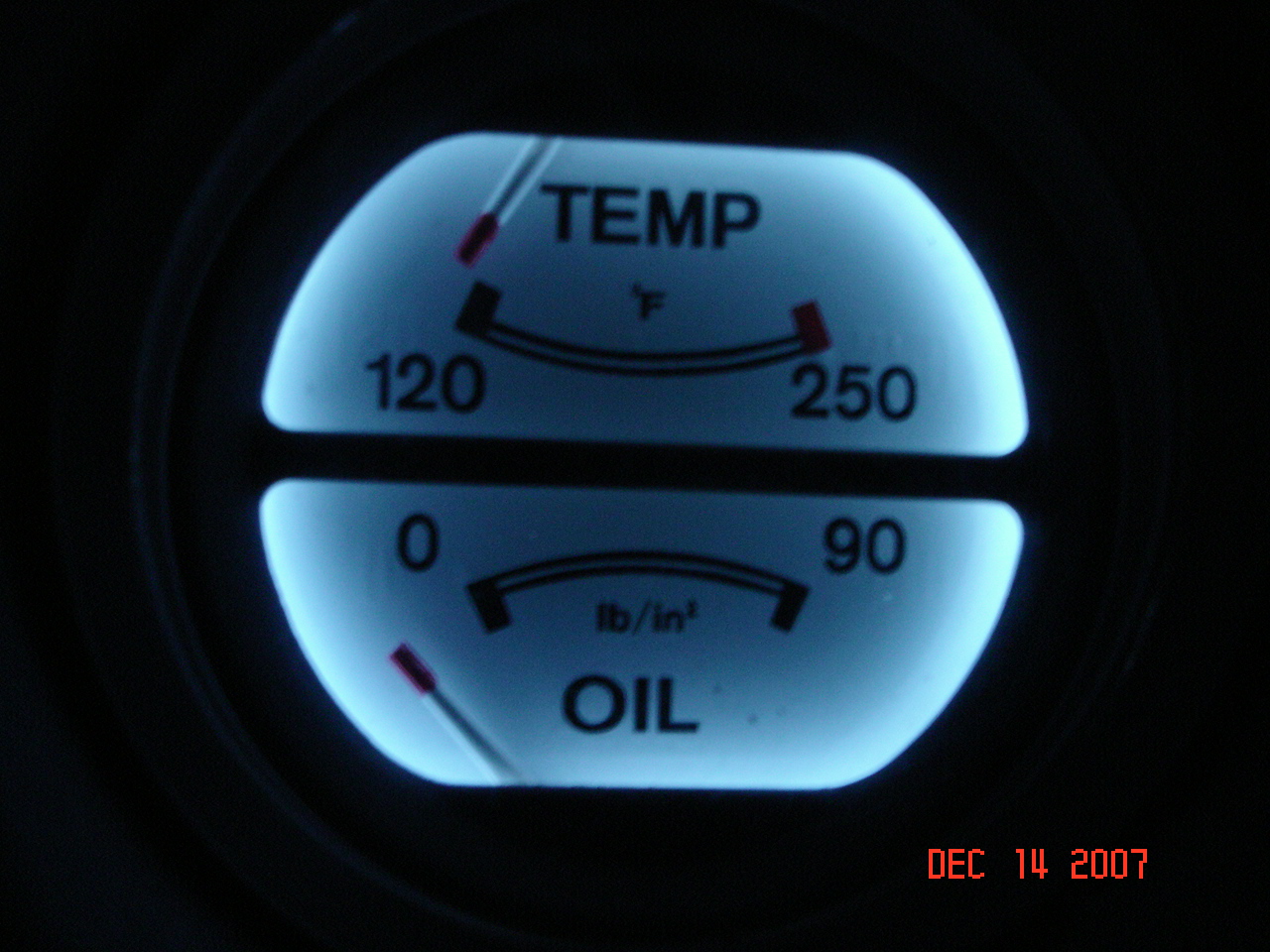

All gauges are lit with those Wide angle white B9 LED's from Superbriteleds.com AND YES, I used the wifes red nail polish for the needle tips for that extra.....you know.

i didn't get those white faces for the very reason that their pic shows it starting at 10mph (even though it says 70-74).
Problem is that there were three separate speedos for 240Zs, and they don't have faces for them all. The Series 1 cars (like yours) started at 20 MPH. Because the US automotive press criticized that highly (along with customer comments, I'm sure), Datsun went from "starting at 20 and centered at 90" to "starting at 0 and center at 80". for the non-Series 1 '71s. At a later point (can't remember if it was '72 or '73) they went to the "start at 10 and center at 85" unit.
I'm going to go out on a limb here and guess that there may not be a proper white face for the earliest speedo like yours. Simplest answer would be to find a used speedo that matches the white face, and keep the original as a spare.

I had written him last year after some jerk outbit me for a set 3 seconds before the auction was up (I HATE THAT!!) We never completed any transaction and I lost his email address.
Anyways, Thank you for his updated email, I wrote him about an hour ago and hope to hear from him soon. My speedo is in peices in a box and would look so much better if it were complete and in the car, ya know.
Thanks again. You'd think MSA would have all 3 available, considering how many early models are still out here.

Here's an interesting thought - if this is the only kit they sell, it's not right for the very latest 240Zs either, as at least some of the '73s came with an ammeter that read from -60 to +60, not -45 to +45.
actually they do make the 60- to 60+ amp gauge sticker and it is sent with the white face gauge set I ordered along with the 45+/- set.
And the other thing is the oil pressure is 145 on mine and they only sent a 90 degree one. as pictured below. I guess I should have payed more attension to the picture and not "ASSUMED" they would have or send the correct set, AND THEY EVEN ASK WHAT YEAR MAKE AND MODEL WITH BUILD DATE, THAT SHOULD HAVE BEEN their CLUE.
So they covered the ammeter option, but not the speedo? Go figure...
