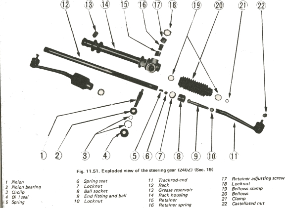

Hello nissanman , it is a bit scary eh , I have a friend who is a journeyman mech who will be helping \guiding me with the ball joints as I have never taken any apart before and i will follow your advice and re-lube and tighten the rack . Surprisingly the rack boots look all around perfect , maybe they were changed out by po . Quick question , on the steering rack immediately to the right of passenger rack bushing , what is\was the plastic knob approx 1 in tall and slightly tapered to the top , kinda looks like a big cap off a toothpaste tube . I say was because when I was changing steer rack bushings I broke the thing off at the base where it attaches to the rack assey . A little embarrassed to admit my sloppy mech skills , oh well . It looks like it is old and brittle anyway . I saved it and can post a pic if no one knows what I'm refering to .

Hey xray, nice car ,I like the green of your Z . As far as spring\struts i ordered Hp's with matching lowering springs .I was told that they are like iluminas at # 3 setting and I'm good with that .I looked a little closer at my haynes and now have a much better understanding of my next tasks . Thanks to all for the help .
