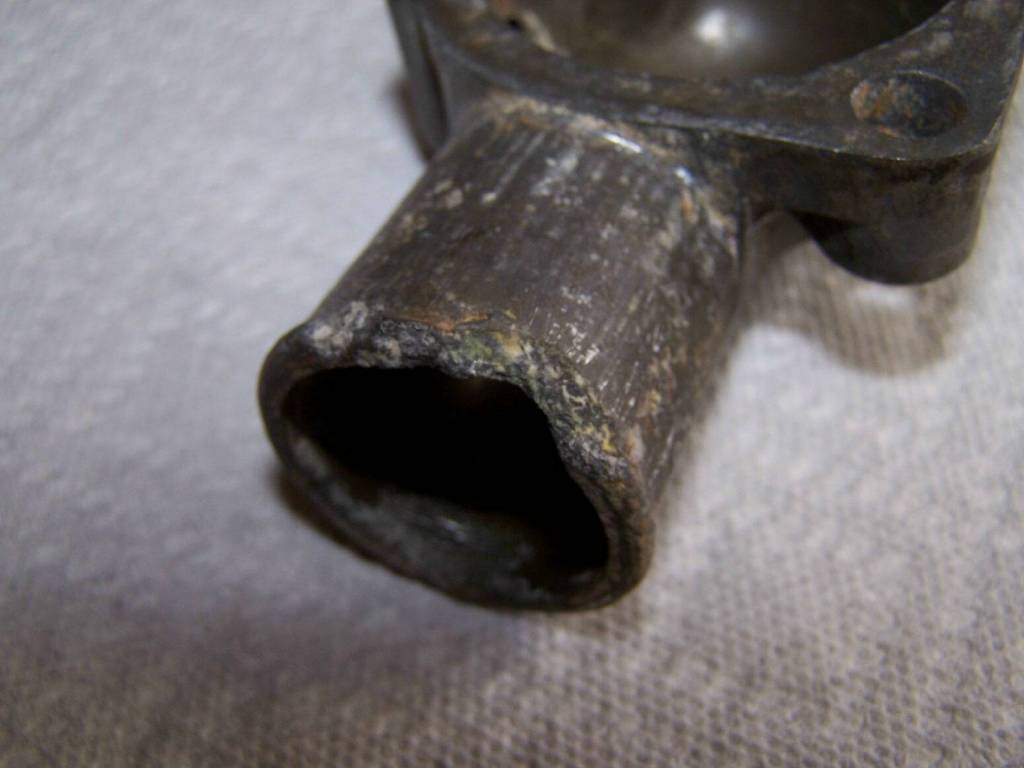

Hi all, I have a 1973 (build date 6/73). I am refreshing the cooling system and found the thermostat cover is a bit corroded (see pics #2&3). It appears that a cover for this build date is NLA. My question is what is this electrical part (see pic #1)? It appears to be a thermo control of some kind and it fits in this cover w/ pipe threads (see pic #2). It is not the water temp sender as that is in the thermostat housing itself. The only thing I have discovered is that it might be a thermo controller for the automatic transmission, however I have a manual transmission. As far as I know it never had an auto trans. The real question is: Can I use a thermostat cover from the earlier model and eliminate this part? The original owner removed all the air emission stuff and replaced the carbs/manifold with '71 roundtops and manifold including the cleaned-off balance tube. Any help from the Z gurus would be appreciated. Thanks, Mike

Thank you Arne and James for your responses. I decided to look in the FSM I have on CD from Courtesy Nissan (well, duh) and lo and behold...all my questions were answered. The part in question is a thermo switch to activate the E.G.R. If I had an auto trans it would also do someting with the distributor. The switch was added to 3/73 240s and 260s to meet U.S. emission standards. (James, could you look on your 73 parts car to see if it's there on the thermostat cover? It may not be as you have a non-U.S. car. Did it have the flat top carbs?) Becuase the PO removed all the emission stuff I have no E.G.R. so I'm guessing the switch activates nothing. I'm going to eliminate it and see what happens. I'm guessing nothing will happen. Once I get my new radiator on I'll be able to tell. Thanks again. Cheers, Mike

Lonny, Thanks for the pic. Mine looks just like that. I found out it was a temp. control for the E.G.R. Not used any more so I'm going to leave it off. I've already wire-tied the wires back to the hareness and taped them up. I have a new thermostat cover (70-3/73) coming from MSA and it has no threaded opening for the temp control. I'll post when the cooling system re-do is all done so there will be an answer to the question "will it work without this temp controll device". Cheers, Mike
Here's the final answer to the question...will it work without this part? YES. Because all the air emission stuff had been removed including the E.G.R. this part (the "what is this?" of this thread) is no longer necessary. I finished the cooling system rebuild with a MSA 3-core radiator, new hoses, fan shroud, new thermostat cover (from the earlier model), new 160 degree thermostat, and new water intake. I thoroughly flushed the block, put it all back together, and added new anti-freeze in a 50/50 mix with distilled water. Took it out for a test drive today and: no leaks, no drips, no errors. It stays cool with the guage needle to the left of center. The heater works. I am a happy camper.
