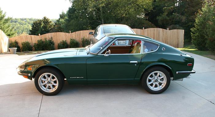

I'm glad you posted this question, I just finished recovering my 73's seat using the foam from Les and it was a piece of cake...( here's a picture of the seat before the final fit), but didn't realize the difference in the seat hardware for a 71 vs 73. I am waiting on covers to be in stock for my 71 Green and then I will start on those. Throw up some pictures when your done.
PS...nice color on your Z, I have the same car only in Butterscotch interior.

Sweet looking car as well! Thanks for the details and pics. Sounds very hopeful for sure! I will post more pics.
