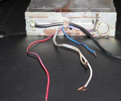

I'm trying to install the factory radio on my 1973 Z but can't figure out the wiring. I'm assuming the PO could have made some changes so here's what I got so far.

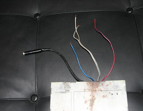

Coming out of the radio I have the following:
Blue wire...........?
Gray.................speaker?
Gray/Blue..........speaker?
Red..................?

The red wire is power. (+12V) The Blue wire goes to your antenna. (raise signal) The gray wires are speaker wires.

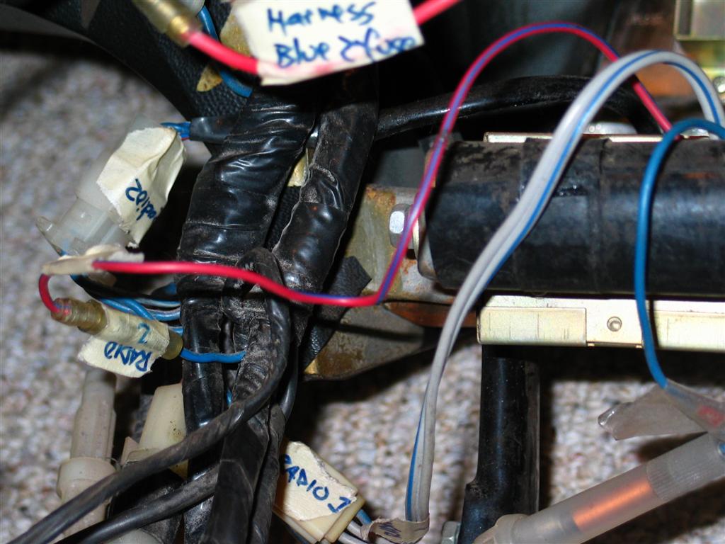

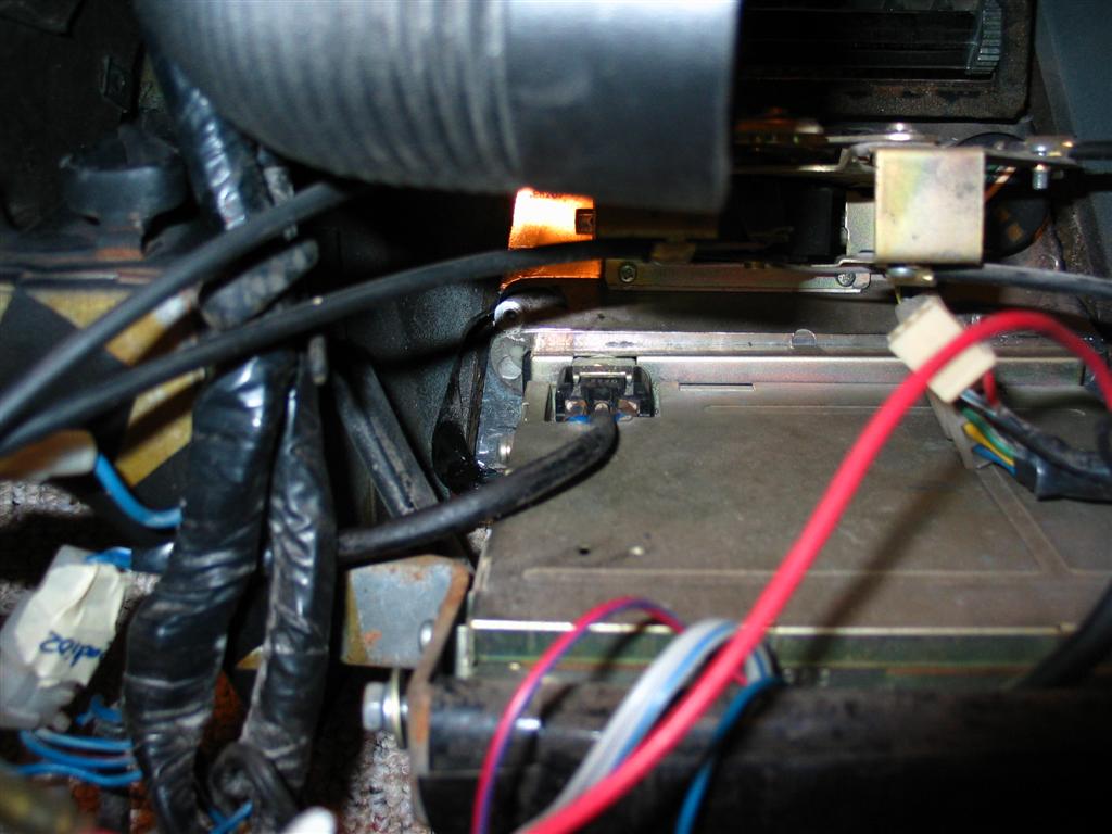

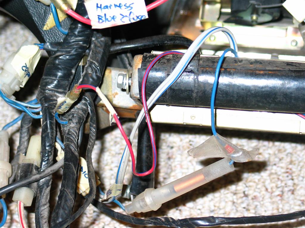

Hi Randy....

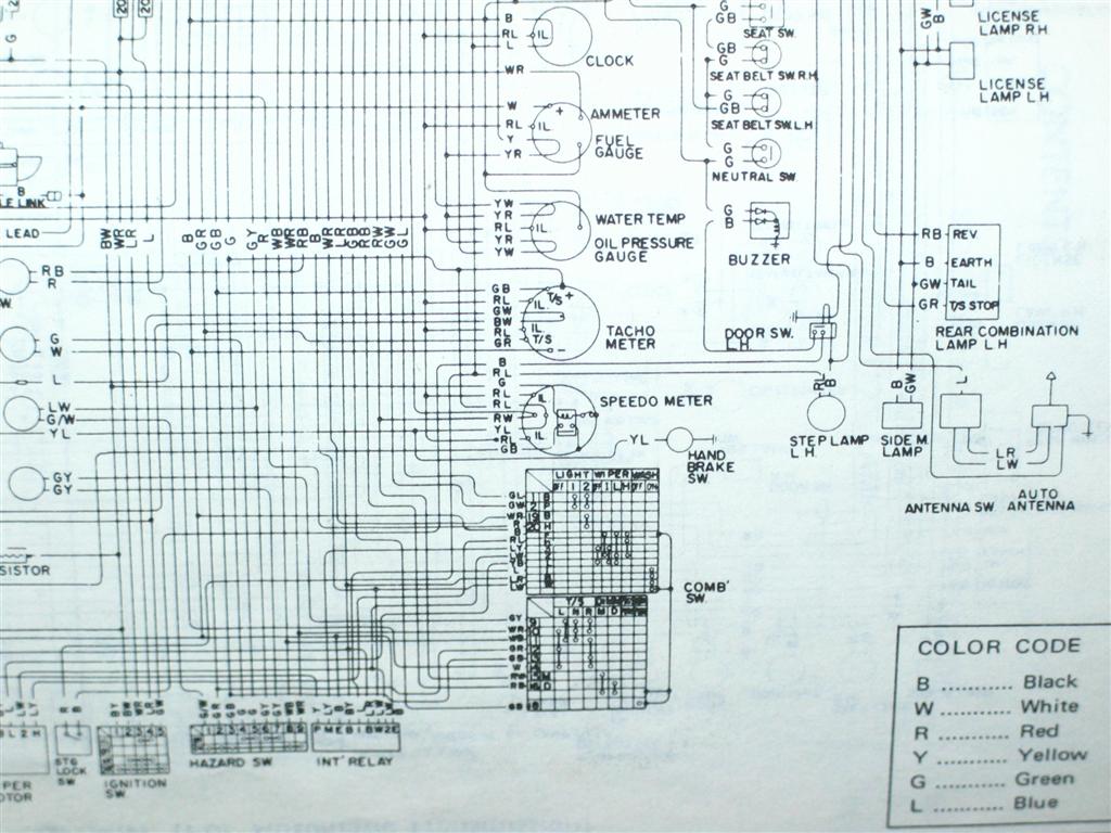

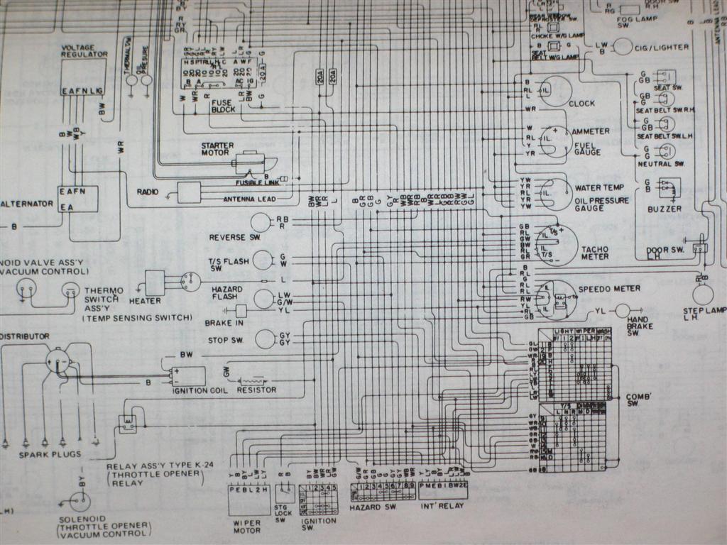

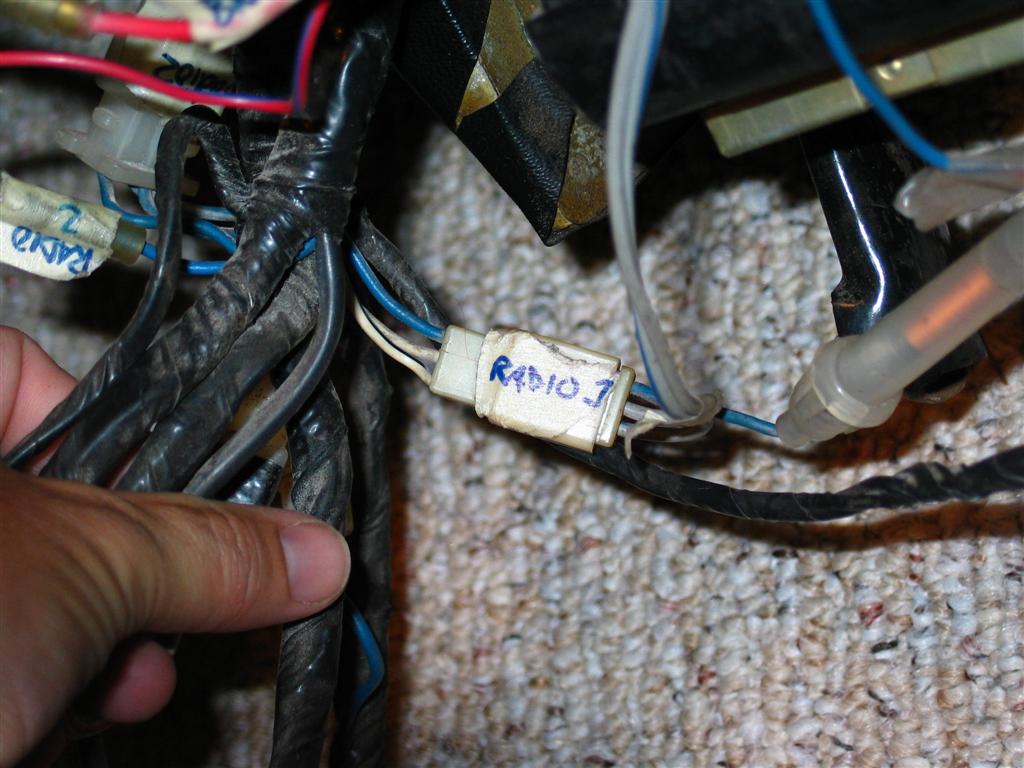

I enclosed a few pics of my radio (with dash extricated from my Z) as it attaches to the wiring harness of the dash. As you can see, two power wires exit, both blue. One, along with the speaker wires (gray and gray/blue) goes to the 20A spot on the fuse block as you can see on my 1973 FSM wiring diagram (page BE-5, for those following along at home...) and connects to the power asntenna. The second connects to the red/blue wire and has an inline 2A fuse. The red/blue wire appears to be along the same wiring backbone as the gauges and illuminator rheostat, probably providing power and lighting to the radio.
I see no reference to a yellow wire, so I wonder if you need to dig a bit further into the harness? (yikes!) Big black wire is the antenna lead.

So I looked a little closer and have to amend what I said earlier. The blue wire from the back of the radio is NOT for the antenna switch (at least not on my radio). My radio (5/72 build) has a trio of wires coming from the front left of the radio right behind....the antenna switch! Blue (main power) with blue/red and blue/white for up/down circuit (section BE page 29 of the 1973 FSM).
I'm no electrical guru (obviously) but it looks like the blue wire from behind the radio provides power while the red/blue wire provides dash illumination along with the other gauges....

The blue wire is shown on the wiring diagram as the power wire for the radio.
The red wire must be the unlabeled wire (on the schematic) that connects to the dash lights.
