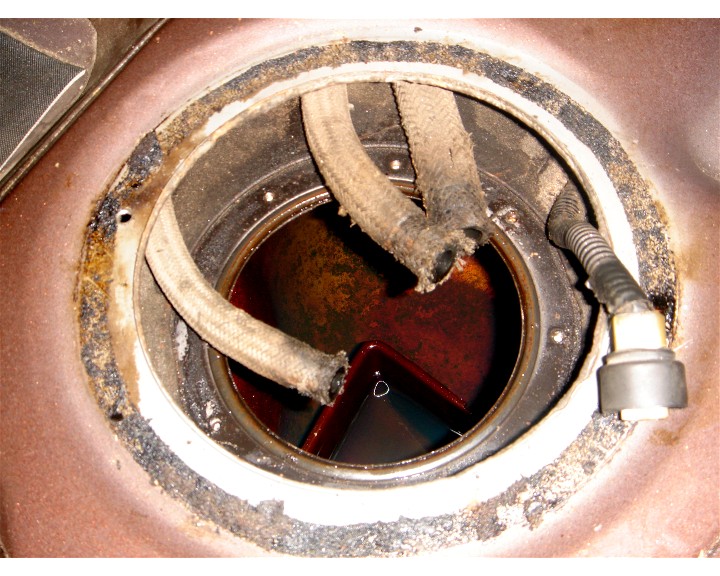

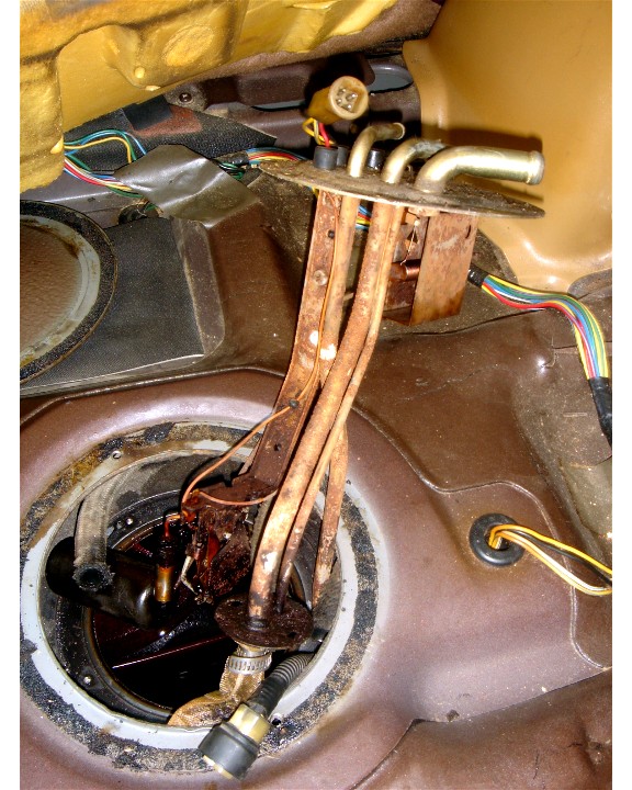

There is a filter on the sending unit, I would expect it to be clogged up, the ZX tank rusts just like your tank does after all.

Here is a photo of my old sending unit-you will see what appears to be a tea filter bag on the end-that was something the PO did (who knows why). If yours is original, you will find a cylindrical wire mesh/plastic unit there, which you should be able to clean up.

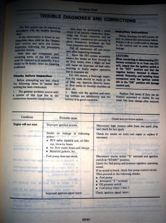

Here are some shots from my troubleshooting section of the FSM. I would imagine there is a way to fool the fuel pump into staying on, though I might think it easier to check the fuel pressure with an applicable guage instead of hacking into your wires; though that's just an opinion.
