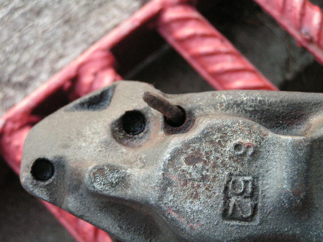

Apparently I inadvertantly got the Finned brake caliper from vented disc toyota pick up.
It would appear I goofed again, so I went back to the Wreckers today , who smiled and said he would be glad to exchange a pair of dirty S12.8 calipers if I can find them for my virtually new looking S13W Calipers.

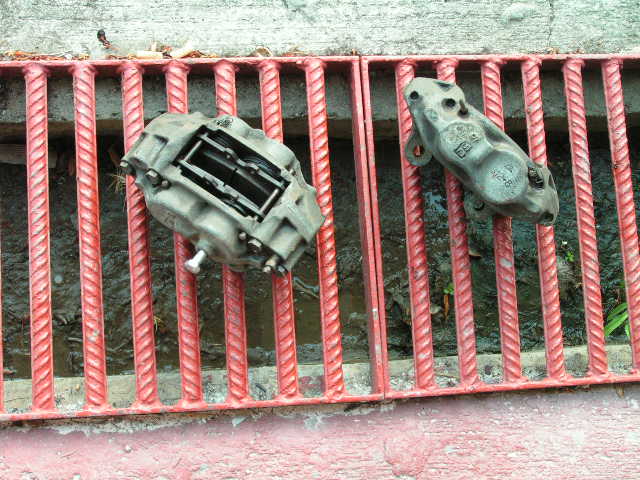

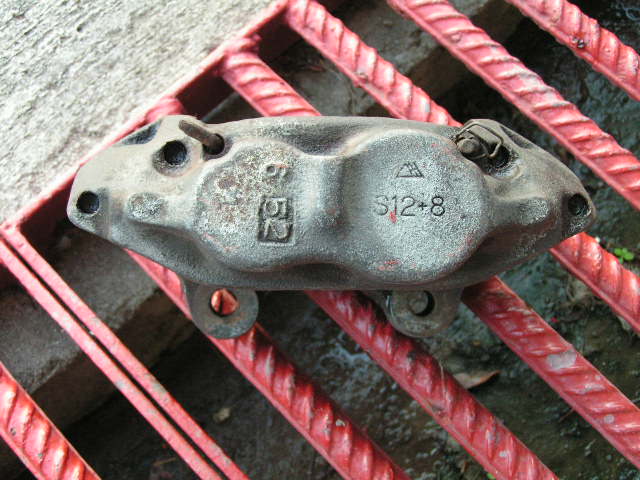

Well they are not looking to bad after a first pass of the wire brush , a good degreasing (can you get purple blaster degreaser in America?) , and a pass with the garden hose. (see pic #149).
As you can see, we are quite innovative in D islands .
If we lose any brake hardware we can usually fabricate something up from scraps found around any construction site!!

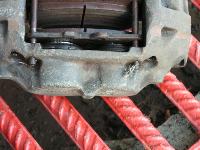

Check brake pad pin replaced with nail in (pic# 150) & (pic # 151)
I can't leave out the ample use of tie wire to replace the original wire clips
(pic # 152).

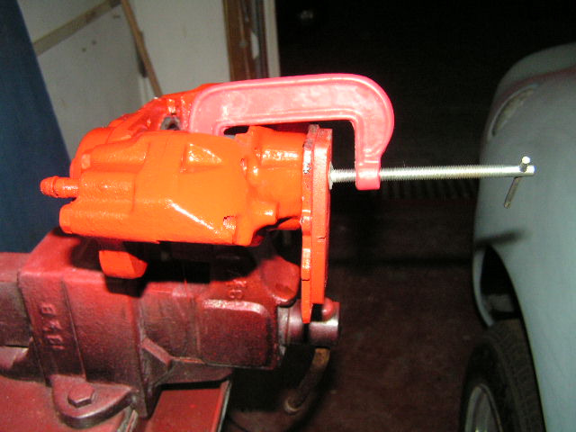

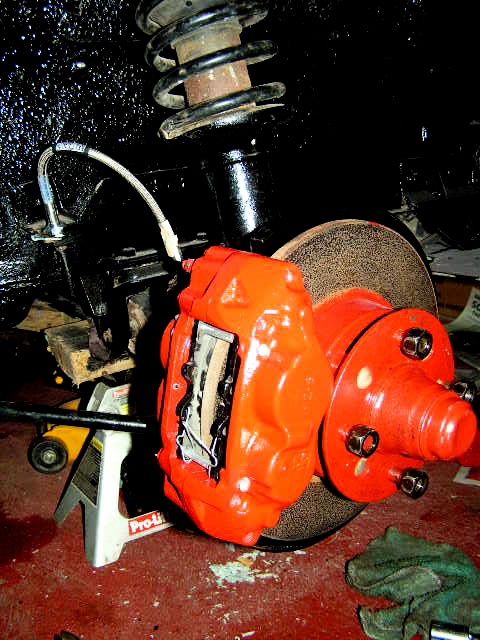

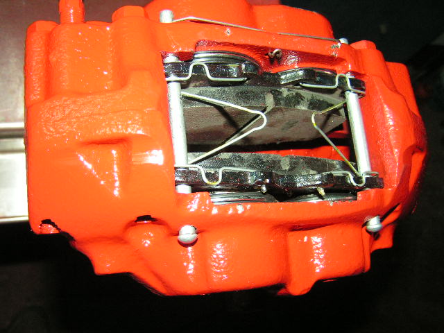

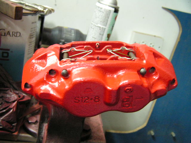

Simply amazing what a little hard work and a new can of paint can do.
Wow , I am actually looking forward to a saturday trek to the Auto Parts Store, for a new set of brake pads.
The S12-W pads are far to large to fit the S12.8 Rotors. Hardware seems to swap no problem though.
Check it out .
I noted that you have two brake pad clips on one caliper. Based on recent research, it appears that only one is actually needed but two certainly can't hurt. At least I wouldn't think so. When I bought my S12W calipers, one case with two clips, and the other with only one. I went back to the store and had a look at the catalog and it only showed one mounted on each caliper. A second check online at a few sites confirmed this for me. In looking at the pics

The two clip thing wasn't really part of a grand plan or anything, just sorta worked out that way.
The Cardone hardware kit came with 2 pad clips and 2 pin clips , thought I'd use the one extra clip I had from a pair of S12W calipers I have lying around.
Therefore if I have one caliper with two and one caliper with one.
I am garanteed in this snstance to be at least 100% correct 50% of the time.

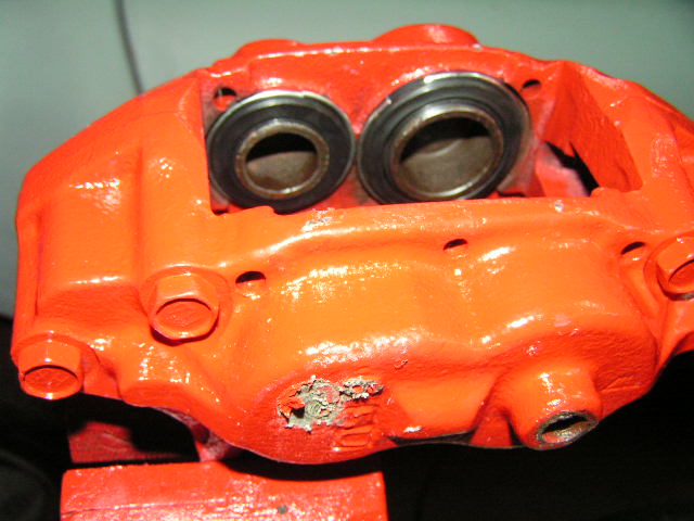

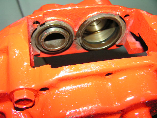

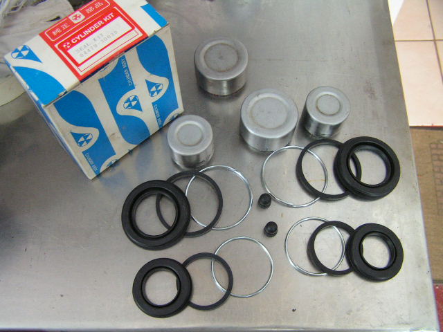

Lucky is not even the right word.

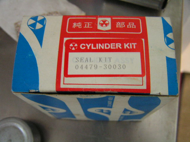

Got the last S12.8 Caliper rebuild kit by a total fluke.
The parts guy actually brought me a S12.8 kit in a S12-W box, I was so impressed with the kit (inner seals/wipers, outer seals, split clips, bleeder cover, and grease that I asked for another to keep as a spare.
When he brought the next one the seals were huge,and no clips probably the S12W kit or maybe even something else .
The Fella spent like a half hour trying to figure what box my kit came from and eventually found it somewhere, lot more bread than the wrong kit of course!!
I had decided I'd better do a rebuild on these old calipers, based on their condition and my heightened sense of beforehand hindsite.
Translation :
I can picture myself driving the eleven miles down hill through challenging corners to work in the morning while trailing a dwindling supply of brake fluid in the system.
Well it appears I am pretty lucky afterall
So all tolled It was
$200.00 for the wrong Calipers(S12-W) the first time at the wreckers.
$200.00 for the wright Calipers(S12.8) the second time at the wreckers.
I could have pressed for an exchange , but ..it was a couple months before I realized I had the wrong calipers. Maybe I might want to do the S12-W upgrade with vented discs later but I doubt it.
Pads $108.00
Caliper rebuild Kit $94.00
So that's $602.00, sounds hot right?
Well When I convert to U.S. (cause that was Eastern Caribbean Dollars I was quoting)
it comes to U.S. $225.47
oh ya and $15.00 for some high heat red paint, though it looks kinda Orange to me!
