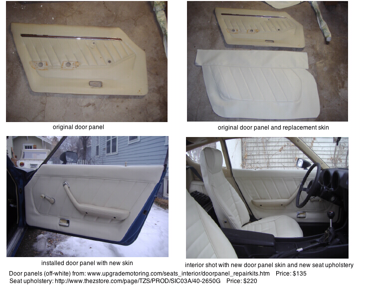

January 9, 200817 yr comment_233353 Hi Everyone, I just finished reupholstering my seats and door panels. The door panel skins came from Upgrade motoring and the seat upholstery kits from the Z-store. The color is off-white, which is a bit lighter than the original, but it looks very good anyway. From the attached pictures, you can see that the new door panel skins are quite different than the originals. I wanted to have some sort of pattern on the new skins. Although they do not match the old ones, the stitching is using real thread (rather than hot pressed), and I think the overall appearance is really nice. Along with the skins, a can of spray adhesive was included. The installation was not so simple. You need to be real careful that the skin is correctly placed on the masonite backing board. I sprayed the central region with adhesive, attached the skin so that it was smooth, and let it dry overnight. For the remainder, I used contact cement since the overspray got all over the new skins. I gradually worked my way around the door panel, gluing sections and holding them in place with clothespins for a few hours. I left the corners for last as the material need to be carefully folded. Also, the felt window wipers were a pain to install. You might want to buy new ones from upgrade motoring or elsewhere (about $40). Anyway, thought my upgrade would be nice to add to this thread. John Link to comment https://www.classiczcars.com/forums/topic/24254-replacingfixing-door-panels/?&page=4#findComment-233353 Share on other sites More sharing options...
