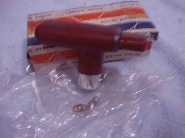

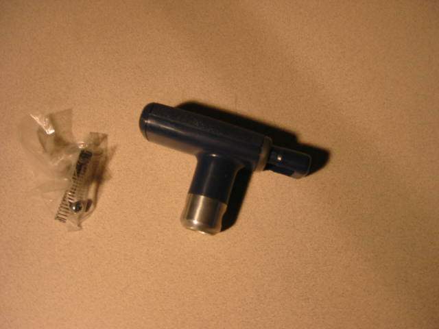

http://www.oem-surplus.com/nwp/index.htm has a couple that might work. The first one is for a 77-80 810 automatic and the second one is for a 210 from about the same era. I'd lean toward the 810 one since they used the same trans. Not reall sure about the 210. Norm is a good guy and he'll sell it to you cheap!

The 810 handle is red, that won't work. Too bad though! I think I'm going to try to find a decent 280ZX handle from a pick 'n pull somewhere. Thanks again!
