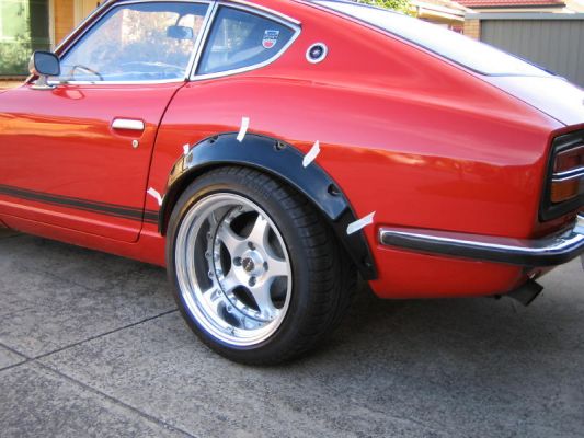

I think one think you might not have realised about why you like the flares is that when the tyres fill them out they do look good but if mount them with 7 or 8 inch wheels and zeroish offset it will look a bit off i think. It really is a catch 22 situation if your not sure about cutting the guards. See if you can get your hands on one rear gaurd and just stick it on the rear with tape and you will see what I mean. I did this with mine whilst waitng for my wheels to come in and it looked pretty scarey...anyhow just a thought before you do any drilling. good luck :D

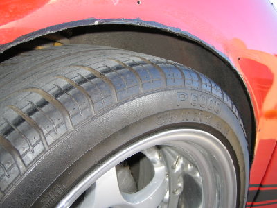

You can see where the tyres rubbed on the cut outs when I used to go over bumps...ouch!ROFL

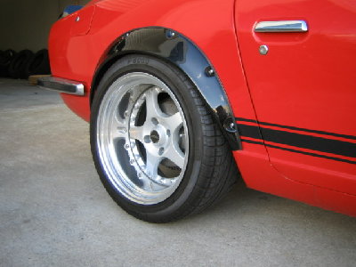

Toecutter your car is one of the reasons I will probably cut mine and put fatter wheels I love the way your car looks. Ian monster thats a good point but I will never sell my Z so thats not a concern. Maybe I should just get them stick them on and if they look good run them until I do get it painted and then cut. thanks for the response guys
If you guys read that thread that I linked to it relates to the way toecutter installed the flares. Judging by my own experience cutting my fenders as well as the info in that thread, I think that toecutter has them too low and I think that he did not cut enough metal off of the lip of the fender. Sorry to be the bearer of bad news, just trying to warn anyone else that decides to cut to be careful of the placement and where they cut...
Jon, yes I agree and should have pointed that out. As a result it still can bottom out when going hard around a corner however my logic was to try cutting that much and always easier to cut more if needed. I did'nt want to cut too high and have the heat melt paint away however I was very impressed by how good a job the TIG welder did and will definatley go higher when the car becomes a priority again after renovations and garage are finished some time later this year.
